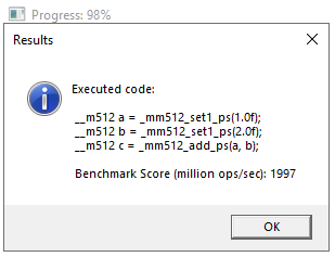

It's LIVE!
Kids can now create their own CPU benchmarks!
(yes, I'm a 44 year old kid...)

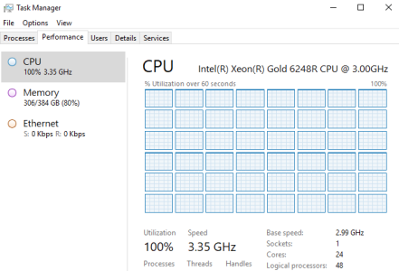

Was planning to benchmark my 9950X3D using LG ExaOne Deep F16 model. On the Xeon 6248R, I got a speed of roughly 3.7 tokens per second. Tried it at home and first, it loads up only the bottom half of the threads in Task Manager. Second, it keeps processing and never gets to the "thinking" stage. Just wastes a whole lot of power for nothing. So I suspect:
1) LM Studio isn't optimized for 9950X3D or getting confused by the CCD crap.
2) LM Studio is secretly co-owned by Intel or AMD or both and it only works flawlessly on server CPUs.
Extremely annoyed since the Xeon was only 41% utilized with max speeds of 3.9 GHz on 24 cores while the 9950X3D was hitting 5+ GHz on 16 cores and still failed to progress to the thinking stage.

The prompt processing part is compute heavy and during that on 16 threads your clocks should be sinking low if the code is well optimized. SMT will be by definition useless in this case.
The token generation part in single user case is dominated by memory BW, during that the clocks will be high, and you could get by with fewer than 16 threads even (it takes 2, pinned to different CCDs to maximize MemBW usage and if more threads help will depend on the model compute needs)
