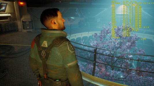

See for example this issue. Vram is at 7.3GBs. 31fps at 4k/balanced.
This is the case for all UE5 games. UE5 is the future. Vram alone aint gonna help.

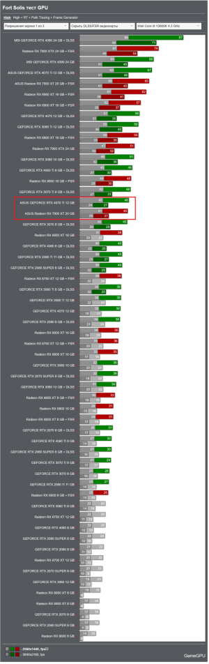

And while we are at it, here are gamegpu's results for fort solis. 1440p and 4k only. I have marked the natives of 4070ti and 7900XT because some guys get confused. The latter has 8GB more vram. It aint helping. At this point, what matters is who has the better upscaler.
Screenshot 2023-12-08 at 12-36-36 Fort Solis тест GPU_CPU RPG_Role playing TEST GPU.png

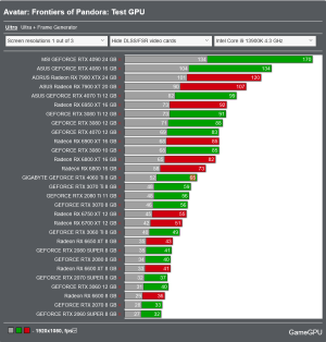

Also regarding the 4060ti, once again, we can see a new AAA next gen title, Avatar Frontiers of Pandora. The 4060ti 8GB is doing quite well. It is destroying the 3060ti, in a very meaningful way, since it's going to a playable 65fps from an unplayable 49fps. They both have 8GBs. Vram is not the issue.
Screenshot 2023-12-08 at 12-57-14 Avatar Frontiers of Pandora PC Performance Benchmarks for Gr...png
Moreover, it's also 80% faster, than the also 8GB rx 6600 and quite faster than the 12GB 3060. These are the examples I care about. And for a 128bit card, son I'm impressed. For a tech forum, people loving money more than the underlying tech, it's just sad.
People in this thread can be posting stupid spilled over examples at 15/30/45 fps all they want. Give me something I can use, like that 60/30 example of the 4060 16gb/8gb, which was ONE game, and I'm game.

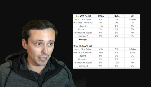

Not the most profesional review, but love this guy:
TLDR:
For raster:
  1. UE5 at 4K Ultra setting, 8GB doesn't seem to be enough. For High or lower quality settings not much of a difference between 8GB and 16GB.
  2. At 1440p you can play on Ultra with 8GB without issues for the most part, although it may require some tweaks.
  3. At 1080p Ultra, average framerate is mostly within error margin, but 1% lows can benefit from additional vram in some games.
My take on this is 8GB is going to be fine at least until PS6/Next-gen XB are released for 1080 and 1440p gaming (maybe it will need some res scaling). 6GB is done, so RIP my 2060.
12GB seems like it's going to be fine for at least 4-6 years unless you want to play at 4K ultra, maxing all settings.
