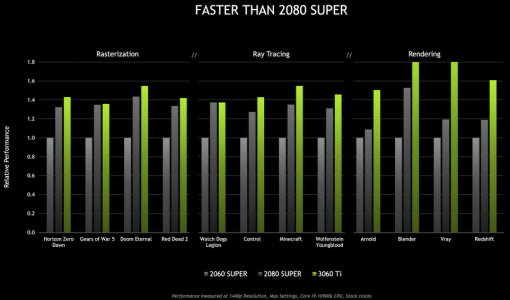

The 2080super is also a 8GB card and for the time this slide was posted, it may have been true. However, marketing will do marketing, that's known and they are not famous for their straightforwardness and honesty. They show performance factors though and not framerates per se. Speaking for myself, I got the 3060ti for 1080p very high/ultra no RT. I got the 4070ti for 1440p (4k dlss+RT). As time moves on, graphics cards tend to move a tier lower. If the 2080super was a 1440p card before, it is a 1080p card now. Cards lose their tiering due to processing power first and foremost and not due to vram though. That's why I say, I have three 8GB cards and they are nothing alike, which you mocked a couple posts above.

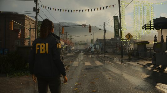

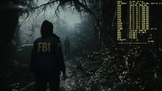

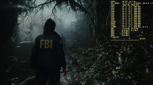

psolord
Sep 16, 2009
2,142
1,265
??? About the 9:55 mark they showed a huge difference in image quality with postprocessing on high vs low with tons of flickering on low, at least in combination with depth of field. Hopefully not the case without DOF since I hate the look and always disable it in games. Don't know why anyone would want a photo filter blurring the background on a game they're playing.
There's seems to be some shimmering in lights in the background inside the mind place ( mind place is pretty cool tbh), but overall the image quality is virtually the same. It can affect the gaming experience in a negative way.

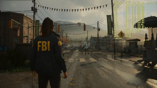

Inside the woods, 60fps is not possible on the 4070ti 4k/high/dlss quality with PP high. It's ok with PP low though.
PP LOW, 60fps very smooth
PP HIGH, game gets stuttery well below 60fpsAlanWake2_2023_10_28_09_50_58_820.jpg

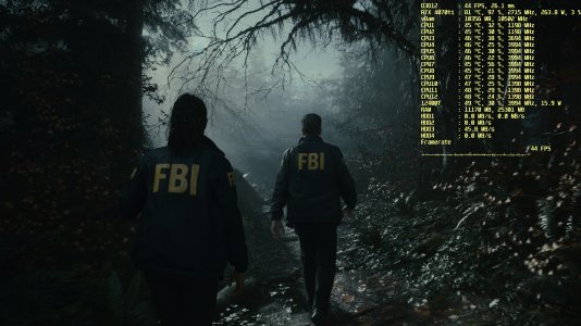

psolord
Sep 16, 2009
2,142
1,265
In town framerate is more stable, but gpu load changes
PP LOW
PP HIGH
