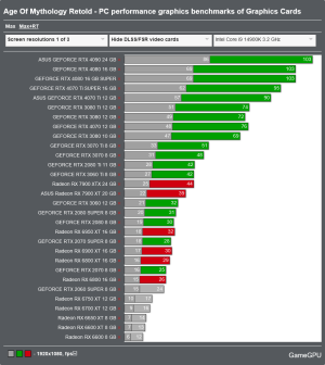

Congratulations, you've found a title that's CPU bound as opposed to GPU bound. I'm not sure what kind of profound point you think you're making here when it has been pointed out multiple times that identifying one game where it isn't an issue does not disprove the point about VRAM being a limiting factor in an increasing number of games.
Ummm....I was referring to the Age of Mythology RT results. CPU has nothing to do with it here. According to your logic, this is a proper result that we should pay attention to, since it's "maxed out" settings right?
Screenshot 2024-09-10 at 12-15-51 Age Of Mythology Retold - PC performance graphics benchmarks...png

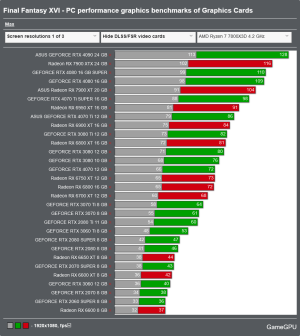

Another PS5 port that is vampiric
Some of W1zz's comments -
1. 25 second loop is not going to translate to what the game needs after playing an hour with heavy fights. Or reveal the other negative effects of low vram.
2. WTF level of upscaling and FG is that, if it'll grab over 9GB at 900p low? That 60fps is going to be a much lower actual fps and feel terrible. What a bad hottake?
Then low it is bro. 25%-40% is going to let cards with enough vram enable FG without crazy lag. 8GB cards will probably be at upscaled 540P to turn it on. Advantage goes to cards with more vram.
Is he just shilling for Nvidia here? Do you guys agree the bus interface speed is impactful here? Nothing mentioned is remotely playable and he was using ultra preset. Meanwhile the significantly less expensive last gen RX 6800 is almost 20% faster than a 4060ti 16GB at 1440 and over 20% for lows. Even the 6700XT is just as fast.
8GBs are fine here too. I showed you above.
This is my 3060ti run. 46 minutes (non monetized). 1080p, DLSS Quality, ULTRA preset.
In order to keep 60fps, DLSS was mandatory. The card runs at 180-200W with 7GBs of vram usage. Meaning it's 100% gpu power limited. In some cutscenes, it is even hitting that although all cutscenes are capped at 30fps.
Also shown below.
The 3060 with its 12GBs, will need both lower settings and dlss. VRAM ain't helping.
Screenshot 2024-09-18 at 11-20-27 Final Fantasy XVI - PC performance graphics benchmarks of Gr...png
