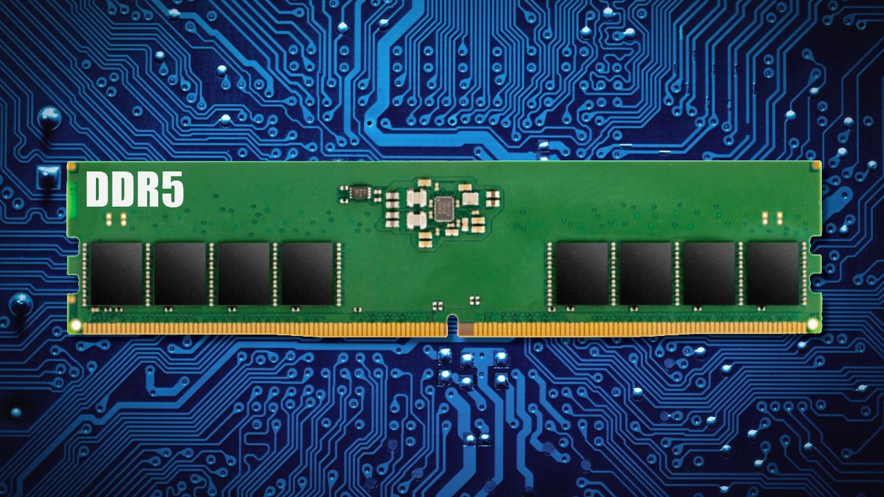

This is your Alderlake sample here
And this is the text below the numbers
CL40 latency (40-40-40-77) may raise some concern, but it's worth remembering that this is only the number of cycles needed to receive data from a memory cell. Better bandwidth requires higher clock speeds for RAM chips - but at the same time, the time per cycle decreases. That's why, despite increasing CL values in successive generations of DDR memory, the access latency actually remains at a similar level.
I'm confused. Isn't that link showing 97% increased latency? Elsewhere on the internet, I've read comments that DDR5's latency will be on par with DDR4's only past 8000 MT/s.
Curious here. Anyone has an idea of the memory size needed for storing say, 90% of most used X86 instructions converted to uops?
It's in the linked article.
CL - CAS Latency
The reduction in latency is particularly impressive when you jump up to DDR3-1600, it only takes 33.5ns to access main memory.
To show the memory latency of the Rocket Lake CPU, the Chiphell user first tested a DDR4-4000 kit with 18-20-20-40 1T timings. The 1:1 threshold led to 61.3 nanosecond latencies in AIDA64 and with a DDR4-3600 14-14-14-34 2T kit with uncore clocks set to 4,100 MHz and got 50.2 ns latency.
Nehalem running DDR3-1600 needed 33.5ns to access main memory.
Rocket Lake running DDR4-3600 needs 50.2ns
Maybe I'm misunderstanding something? Yes, Rocket Lake fetches tons more data than Nehalem in a given time period but actual RAM access latency has increased, no? DDR5's leaked benchmarks are showing that it will go over 100ns. How is that better?
Check out the table on this page for the actual ram module latencies.
DDR3 1600 : 13.75 ns - 7.5 ns CAS 11 - 6
DDR4 3600 : 10.56 ns - 8.33 ns CAS 19 - 15
