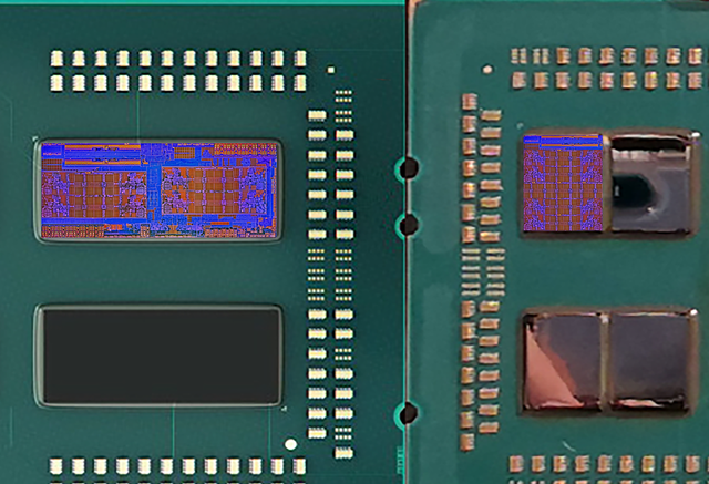

I got 420 mm^2 for the I/O and 72 for the CCX. Close enough. The edges are hard to discern.
May I use your pictures in case I need them for illustration in future?
Ofcourse you may. 🙂
They did really polish that baby up for the beauty shots... 😛

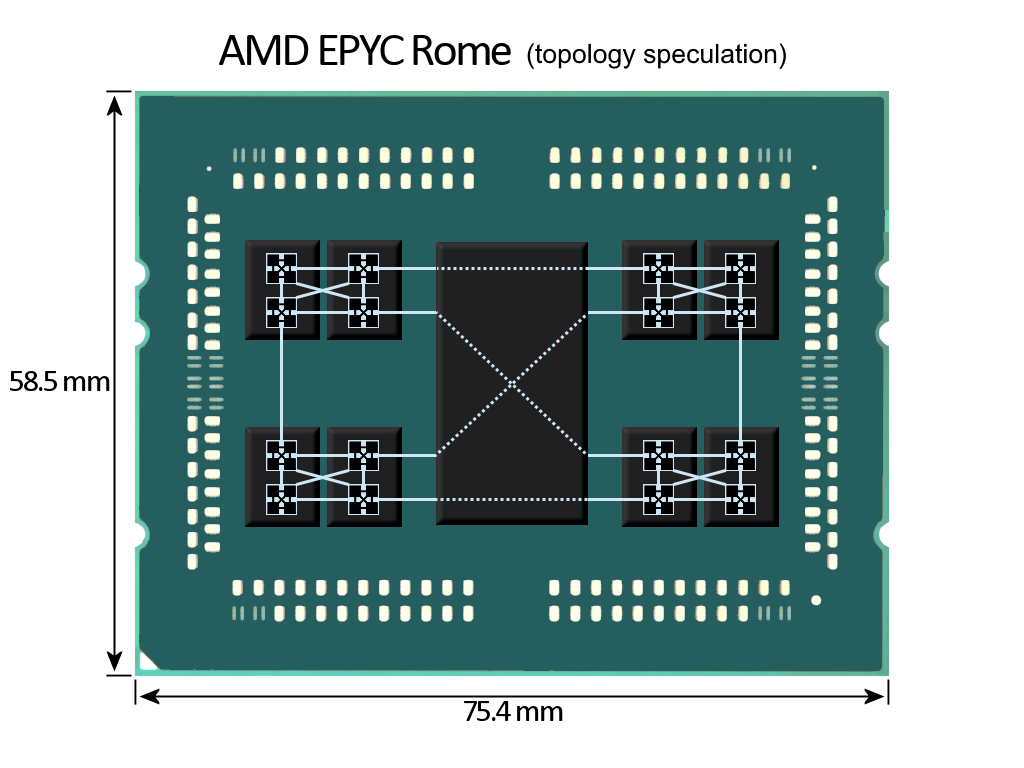

Please feel free to use any of the images and draw over them to better illustrate how everything is connected together.
Thanks for your diagrams! Here is my attempt to reconcile the chip layout with my ideas about a "quad-tree" topology discussed in my CCX speculation thread (here), assuming each CPU chiplet consists of two 4-core CCXs, where each pair of chiplets forms a fully connected cluster of 4 CCXs (16 cores), and where these clusters are fully connected to each other.

Perhaps that's why the chiplets forming each pair are mounted so close to each other? For some edge connection? Or the pair sits on top of an interposer which provides the interconnect?
The topology would offer some nice VM partition sizes; 1-4 fully connected cores within a CCX, 2-4 fully connected CCXs (8-16 cores, max two hops), 2-4 fully connected CCX clusters (32-64 cores, max three hops).
With Zen 3, on a more mature and cheaper 7nm+ process, they may replace each pair with a single 16-core die (4 CCXs) and optimise the CCX interconnect on-die.
Perhaps that's why the pairs are mounted so close to each other? For some edge connection? Or the pair sits on top of an interposer which provides the interconnect?
Distance between the dies shouldn't change too much in terms of die size consumed by IO, and there just isn't much room. I'd guess that there's only a small chance of something like a single connection between close together dies, with anything beyond that being extremely unlikely.
I think they are close together because of pin routing, remember this still has to be current socket compatible, remember how the layout used to work(naples).
Dram on the outside, IF/pic-e on the inside. they dont want crazy routing of all those pins in the package. So by putting the two chiplets close together the way the pins map to the dies stays close.
There's close to no chance that there's enough room in each chiplet for 2 distinct core complexes if there's also 32MB of L3, and even with only 16MB of L3 you certainly aren't going to find the space for that much IO.
I also agree that in order to have all of those IF-links, a small silicon interposer is required under each pair of chiplets. I don't see any interposers there but on the other hand, there's too much glue to see anything. IFOB-links (Infinity Fabric On-Package) have power efficiency (PE) of ~2 pJ/b while IFIS-links (Infinity Fabric InterSocket) have PE of ~11 pJ/b (source) or rather ~9 pJ/b (source). On-die has PE of ~0.1 pJ/b and PCIe/DDR something like ~20 pJ/b. Technologies like silicon interposer or EMIB has PE of under 1 pJ/b (source) and therefore in the future AMD should (and they probably already have) really look into those bridge chiplets.
I have no idea what the underlying topology would be either for the chiplets or the I/O-die but they both have the same amount of nodes (eight cores and eight chiplets). However I'm interested to hear any ideas anyone might have tough.
Edit: Let me rephrase that. If each chiplet has two CCXs each having four fully connected cores (crossbar topology) then what's the point of having 8 chiplets instead of 16 (4-core chiplets). If there really are silicon interposers under those pairs of chiplets then those four CCXs (on two chiplets) would be fully connected (crossbar again) on a higher level like Vattila has shown in the diagram. As long as there is enough room for all the microbumps in the chiplets (I think that normal C4 bumps are much larger) this should be somewhat possible using a silicon interposer.
The highest level is currently a bit weird because some of the connections run through the I/O die (as I understand it) and some are directly between chiplets. If the interposers would be active (containing logic and transistors) then maybe all four active interposers would again be fully connected together (crossbar once more) even on a higher level. That would be a routing nighmare probably even worst than Naples because now there's also the I/O die on the way. On top of that there would be additional IF-links from each chiplet to the I/O die. I feel like the organic package in Rome only contains 8 links from each chiplet to the I/O die and all complexity of the routing is hidden inside each node (either a chiplet or the I/O die). Choosing a good routing topology to more than 4 nodes is quite a hard problem it seems.
While Vattila's basic idea is good there are a lot of problems related to running a lot of wiring in an organic package where the Rome chiplets and I/O die sits on. Then again there are a lot of problems with 8-core CCXs also.
And then there is always the possibility that they (AMD) have switched to some kind of ring bus topology which might be fine. I think that a mesh or something like the ButterDonut topology should probably be reserved for cases with more nodes and maybe active interposers.

Regarding Rome, the seemingly leading hypothesis and obvious alternative to my "quad-tree" topology, is a star topology with all traffic (memory and cache-coherency) going through a central switch on the I/O chip (with L4 and cache-coherency tags/directory). However, that hypothesis was argued to a large degree based on having all the chiplets being equidistant from the I/O chiplet, preferably with a low-latency wide edge connection or interposer solution to keep latency down.
Now it is clear the chiplets are not connected that way, and they are curiously mounted in pairs. There is no wide and fast connection connecting the CPU chiplets to the I/O chiplet. I.e. the traffic to and from the I/O chiplet goes through relatively high-latency serial IF links on the organic package substrate.
Perhaps the design isn't as uniform as believed. Imagine that the spare IF port in each CCX cluster at the corners of my diagram is connected to a dual-channel memory controller on the I/O chip, plus a slice of L4 cache.
Welcome. I am honoured to have brought you out of the shadows. 🙂
If you have each chiplet pair connecting from the center of the pair, then aren't the connections equidistant? Star topology can work now.
I wonder if AMD is doing this to for power savings via their old technique of "resonant mesh clocking". Chiplet to IO die distance appears uniform for all 8 chiplets and a tuned resonance will lower power needed for signalling.
Having all of the CPU traffic cross a package will burn a lot of power in normal circumstances. Something unforeseen must be happening.
