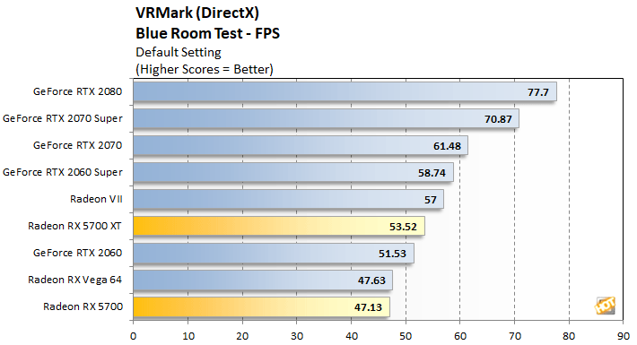

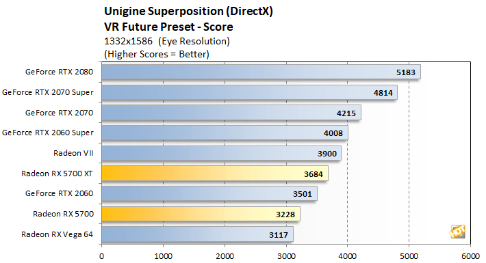

tajoh111
Mar 28, 2005
298
312
I hate to say this like this, but in this regards this is really bad advice, and you owning AMD stock should really be made clear if you're going to suggest AMD in a bad faith example as this.
Indeed.
https://hothardware.com/reviews/amd-radeon-rx-5700-xt-and-rx-5700-review?page=2
A 30% advantage overall is nothing to scoff at.
