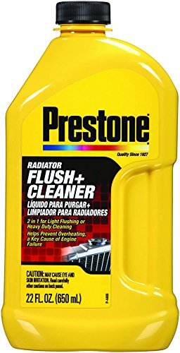

If its a used radiator, i typically use a radiator flush.
But this is only if the radiator was used for a while...
It will dislodge scaling + premix deposits, but it requires a lot of post flushes with clean water afterwards as you dont want it left in your radiator.
Hence u will only need to go route 2 when you either buy a used radiator or its been in use for a while.
