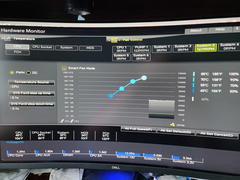

Here's what I get in the BIOS:
Wait ..what do those "buttons" do?
Ah...that's better.
Ah...that's better.

OK, so you just have one connector for the AIO. That just means that the pump and AIO fans will all adjust together. So the case fan hub is connected to SYS_FAN3? That doesn't look like what I'd expect from a PWM connection. Click on the cog button and see how it is set up.
Apparently, the motheboard only registers the AIO pump speed since the fans and pump are daisy chained. (not this pic)

That looks better. The curve seems a little aggressive. If the fans are a little loud you could always pull those dots down some. Don't be afraid to play around to suit your needs. I typically set mine up more like this one to keep noise down.
BoomerD
Feb 26, 2006
66,547
14,942
Yeah, I haven't messed with that yet. The Silent Wings 3 fans are much quieter than the Arctic Cooling ones. Surprising to me.

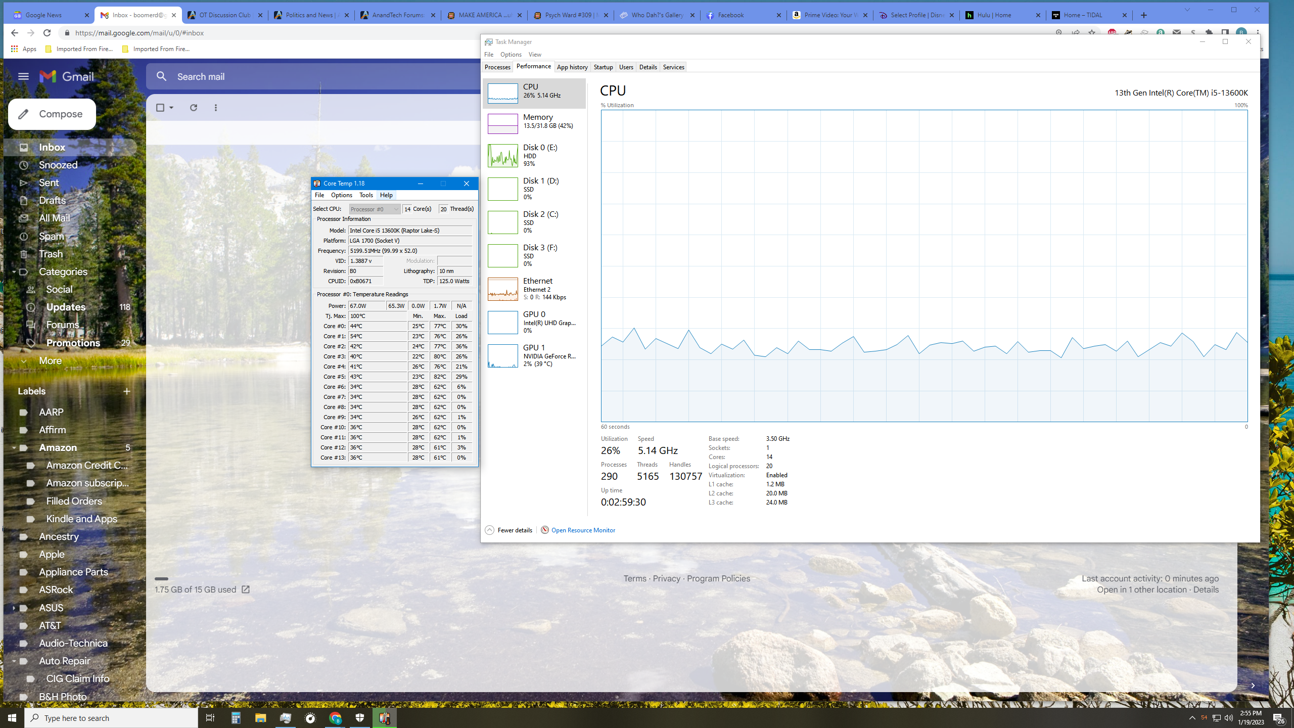

So far, I'm kind of disappointed in the Arctic Cooling Liquid Freezer II 280mm AIO. Seems like it SHOULD do a better job than this:
Surfing various websites...including <gasp> Facebook...and running a Windows Defender scan in the background. (keeps picking up a warning from something in one of the old drives I had connected...but is no longer.)
28,173
19,203
Yeah. I think BoomerD is expecting the Arctic cooling to give him Arctic temperatures :p
But seriously, experiment with undervolting a bit. I think your performance and temps could both improve nicely.
