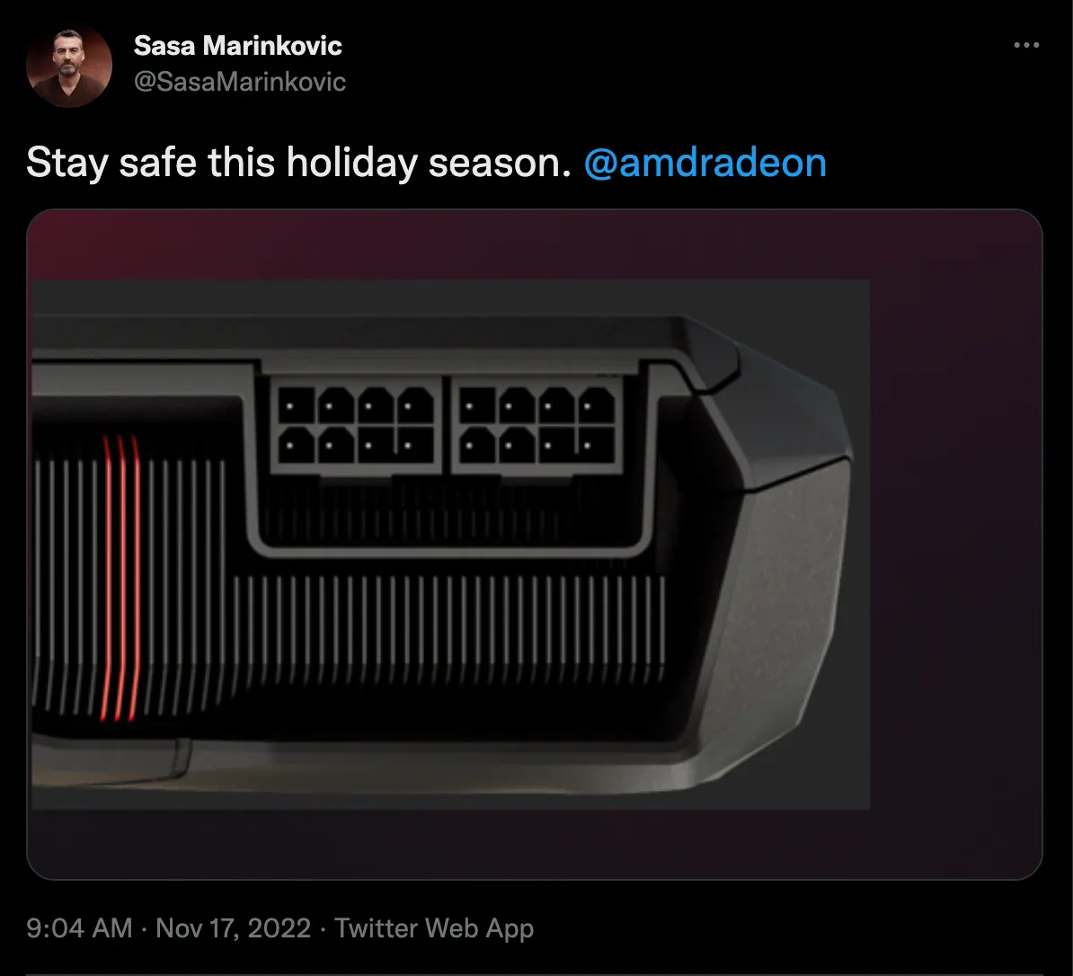

AMD exec recent tweet... 😛
I don't think bringing up AMD losing a lawsuit over attempting to use the ALU count as the core count is really equivocal here. I mean... Nvidia isn't being sued for false advertising. Frankly, the GamersNexus report gives Nvidia the best ammunition that it needs in a lawsuit: "Failures have been attributed to user error." (I'm sure Nvidia has been looking into this themselves as well.)
