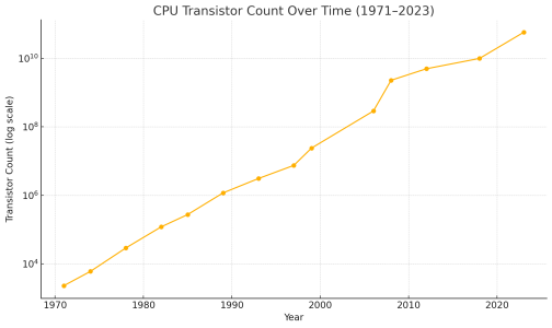

Cost per xtor is going *up*.
A few people say that. But because it is not reflected in customer product prices I highly doubt that:
  • 6700XT, 12GB, 480$, 17.2 bTr, 335mm2, N7
  • 7800XT, 16GB, 500$, 28.1 bTr
  • 9070XT, 16GB, 600$, 53.9 bTr, 357mm2, N4
So we have here 1.3x MSRP increase with 1.33x VRAM and 3x transistors. With the difference of N7 vs. N4 in between. Chip size of N22 is similar to N48 and because N48 is sligthly bigger, somewhat higher costs can be assumend. And yet, consumer prices are very similar. There is no chance, that per-xtor cost has gone up because otherwise AMD would sell N48 cards at a loss.
So as a result, I definitely do not see any evidence of cost per-xtor going up. Same applies for CPUs, where transistor count has increased by a lot as well (looking at Zen 3 to Zen 5). All in all a very similar situation as observed for GPUs:
  • 5700X, 300$, Zen 3 CCD, 4.15 bTr, 80.7mm2, N7 / 2.09 bTr 12nm IOD
    • I exclude the 450$ 5800X here
  • 9700X, 360$, Zen 5 CCD, 8.32 bTr, 70.6mm2, N4 / 3.4 bTr 6nm IOD
We do not know the trends for N3 or N2 yet, but looking at Apples M3 and M4 and their Mobile SoC siblings, I do not expect massive price increases as well. Cost per area goes up, for sure. There is no doubt about that. But per-xtor is the chance very close to zero.

It's literally the only factor and it has not only slower, it's reversing.
No it's not. Chiplet technology, packaging, memory speed, and a bunch of other technologies are all outside Moore's law and contribute greatly to performance/$

It's gotten cheaper because moore's law.
Moore's law is very very very dead.
Computing is still getting cheaper. Moore's Law isn't dead, its just slowing down.
Compare what you could buy for $500 or for $5000 five years ago with what you can get today. Can you not get more and faster cores, better GPUs, more RAM and bigger/faster SSDs at those same $500 and $5000 price points? Can you not build more server capacity (vCPUs, gigabytes of RAM, terabytes of storage) per dollar than five years ago?
So explain why you think it is getting more expensive? That's only true if your needs and wants are growing faster than the above improvements are happening, which doesn't mean computing is getting more expensive it means YOU are getting more expensive!

No because GPU is more than just the KGD in its center.
If you would deliver arguments instead of 1-liners without any meaningful content....
Lets take Sapphire 6700XT Pulse vs. 9070XT Pulse. Same manufacturer. Same device class. Same device branding.
- 480$ vs. 600$ -> 1.25x
- 335mm2 vs. 357mm2 -> 1.07x
- N7 vs. N4 -> according to AMD 1.2...1.3x or so (some uncertainty there)
- 12GB 16Gbps GDDR6 vs. 16GB 20Gbps GDDR6 -> 1.33x with higher speeds (but memory should have gotten a little bit cheaper per gigabyte)
- 2-fan vs. 3-fan -> 1.5x
- 230W vs. 304W -> 1.32x
- 9+2 vs 11+3 VRM phases
- PCB size got actually shorter, but maybe 2 layers more
So everything I see there has roughly linearly increased with MSRP. The GPU Die could be a little bit more expensive than the MSRP increase would indicate, hence slightly reduced margins per card might be true. But if the case, not by much.
And now for you to understand:
This is not a per-xtor comparison. This is a component cost comparsion. That is something completely different. 3x more transistors at 1.25x higher price cannot be compensated by other components or less margin. But if you think that is possible, please provide us a explanation or calculation of that.
We have following metrics:
1) Cost per Die area -> goes up
2) Cost per xtor -> goes down, much more than 1)
3) Cost per performance -> goes down, but slower than a few years ago because 1) and 2) work against each other
Moore's Law as it was defined in the 60's and 70's is dead, yes. It is not a doubling of transistors every 12...24 months at the same costs. But transistor cost still goes down.
- Just as a side note here : Moore's Law was mainly a consequence of Dennard's Scaling. That is the true physical effect and foundation behind Moore's more business related prediction. Dennard's Scaling ended ~2005
In the early days, this doubling of transistors resulted in a doubling of performance as well. This has slowed down even more than the transistor cost decrease, see 3) above. But still, performace per cost goes up. In some areas even more than Moore's Law (when accelerators get introduced for some task or ML/AI renders all existing approaches ineffective and useless).
