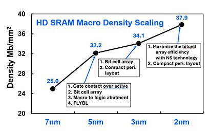

Latest data from TSMC has N2 SRAM density at +50% over N5
Edit: Sorry it's actually +50% over N7, +18% over N5
While price of N2 will be up to 4x, which would be paying 4x but receiving only 1.5x.
Which means the value proposition for stacking SRAM on a cheap mode improves. We may already be in the area where cost of stacking equal amount of SRAM on stacked die is cheaper than keeping it on main die. (after the overhead of stacking)
But if you consider that the separate die can hold 3x to 4x SRAM, then the increase of L3 size is gravy.
Reactions: Win2012R2
