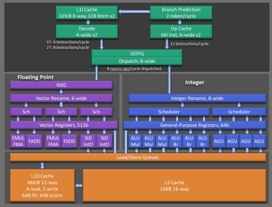

Is there a chance that AMD will do full 8-wide design instead of 4+4 or even 10 wide?
No chance... AMD said Zen 5 is their new foundation and they will built upon it, plus it seems that very wide Intels design is not yielding that much more, I reckon 5+5 with working dual branch prediction without SMT might be very very nice.

Wider than Skymont?
What about Zen 6's front end? Is there a chance that AMD will do full 8-wide design instead of 4+4 or even 10 wide?
Zen5 is 8-wide design, as it is 8 wide at rename and if you are running from uop cache you are able to sustain 8 instr in flight;)
No, it isn't: 4+4 (especially with not working second decoder in non-SMT scenario - according to Cheese&Chips) is not the same as 8 wide fully available for single thread. It was clearly designed to push SMT with some hope it can be made work also without, but does not seem to be the case at the moment. I hope they will upgrade it to 5+5 at least, or maybe they should just go to 6 wide single and be done with it, I hate SMT with a passion.
It is 8 MacroOp wide. That means at peek it can execute 16 instructions.
Not when per thread decoder can only decode 4, your chart says that very clearly: 1T: 4 instructions per cycle, 8 will only work in SMT, which is why Zen 5 got better than usual uplift in it.
You are wrong. Reread the articles you mention. Since most of the time code is being executed from uop cache that can dispatch 12 uop to rename, the decode throughput is less important. If you want further confirmation read Zen5 optimization manual to learn how decode and uop cache interact with each other.
And Alex Yee tested that when mixing SIMD and integer code you can in fact reach 8 inst per cycle without SMT.
No, 1 thread Zen 5 can work at peek throughput when instructions are coming from Op Cache which is majority of time. What you are mentioning only valid for dual decoder and not for Op Cache. As I linked above, Zen 3 can execute ~10 uOps/Cycle with an IPC of 7.7. For Zen 5 it should be higher.
Ok, it's getting above my pay grade. But I will correct you on the peAk bit though!
How often does that happen in existing code? It does seem exotic to me
Everytime when you are using mixed integer and floating point computations. Scalar FP is handled by the SIMD unit anyway. In SIMD heavy code you still need to use scalar int part of the core to generate addresses and handle loop control.
So probably the only time it does not happen is when running scalar int only code.
I mean in terms of opportunities to make full use of the machine width, of course waiting for data etc results in lower ipc.
