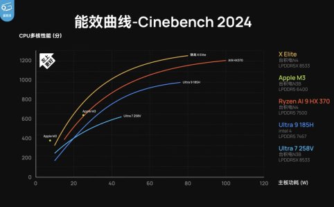

CPUCoresCinebench 2024 Multi
Ryzen AI HX 3704 × Zen5
8 × Zen5C
1200
Ryzen 9900X12 × Zen51750
If we assume Zen6 is 15% faster (+10% IPC, +5% clock), that means a 12-core Medusa Ridge will score ~2000.
A 12-core Medusa Point will not clock as high as the desktop counterpart, so let us subtract 10%, which gives ~1800 points. That's 50% higher than Strix Point.

Yeah so you don't care about the power difference between HX 370 and 9900X? because that is the key metric here.
Again, maybe at like 80W power limit or something like that I could see it close to that, because at that point the 5c version starts being in a much worse point in the curve efficiency wise. But overall, 50% is a pipe dream with the same core count at reasonable power limits.
For what is worth, HX 370 1200 points is already at really high power limit iirc

@FlameTail, Zen5 and Zen5c are exactly the same architecturally, and perform exactly the same. With some fineprint.
(The fineprint: Zen5c has a lower peak clock. Zen5c has a tiny bit better performance/Watt in workloads which are not sensitive to uncore parameters. Zen5 and Zen5c in StrixPoint differ WRT uncore: 4 cores sharing 16 MB L3$ versus 8 cores sharing 8 MB L3$.)
In workloads which are not particularly sensitive to uncore parameters, Zen5 in mobile and Zen5c in mobile have exactly the same iso-clock performance and almost the same iso-clock power draw, as long as they stay well beneath their f_max. The upshot: If your CPU-limited workload is power-limited, not clock-limited, then it almost doesn't matter if you have Zen5 or Zen5c or a mixture.
Vice versa, workloads which are sensitive to uncore parameters behave different on Zen5 and Zen5c because AMD chose to give them different uncore.
Cinebench is not particularly sensitive to how the uncore is set up, AFAIK. Especially not earlier Cinebenches; maybe it has changed a little with CB24 due to larger data footprint of the benchmark scene.
(More fineprint, but not directly impacting the Zen5-->Zen6 extrapolation: Zen5 in mobile differs from Zen5 in server. Zen5c in mobile differs from Zen5c in server. Zen5 in server is manufactured on a different process node than Zen5c in server.)
Of course it remains to be seen what strategies AMD will pursue WRT classic and dense cores in Zen 6 products. But there is little reason to suspect fundamental differences to how they chose to do it in the Zen 5 generation.
