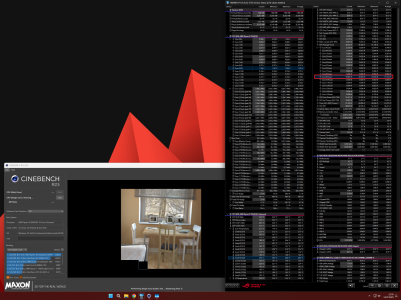

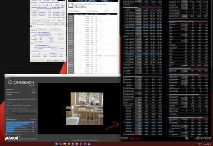

N4P 9950X @ 5.7GHz uses ~35 watts. Will AMD maintain this level of power consumption at >6.0GHz?
A single PBO boosting Zen5 core @ ~5.85ghz uses 11.1w average in Cinebench R23 ST according to hwinfo
Totalt PPT is ~50w

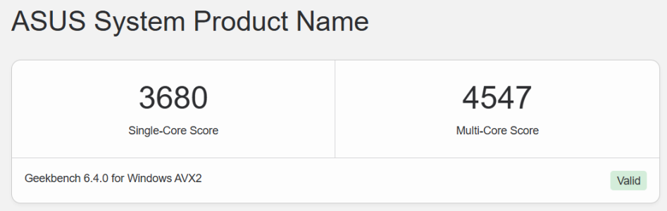

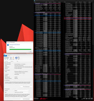

Can you try using Geekbench ST?
GB6 locked with affinity to a single Z5 X3D core with SMT enabled
HWinfo cant keep up with such a bursty workload, so average power usage it out the window, but max draw was ~15.7w with 2 threads enabled on a single core accoring to hwinfo
