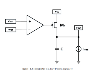

Nothing is wrong with that pic, since I posted it along with two others just for illustrative purposes as an example of LDO VR, and the context of that post didn't imply any particular implementation thereof.
So this complaint is "Not accepted" (in a hope you've got something more substantial to back up your "clueless").
PS: regarding the scheme itself - it's analogue LDO btw, and if you really design ICs, then you wouldn't call error amplifier a comparator. This alone raises doubts about that, Dear IC designer ))
Lol, playing with words without knowing their meaning, the wording i use is right, this is a comparator, that s the right terminology wich is generic because it s a circuit that compare two or more values, there s not only error amplifiers used as comparators, in PLLs that generate frequencies using a quartz as reference an EXOR gate is often used as comparator...
As i said, do your homework, you just embarassed yourself yet another time...
Edit : Think a little rather than trying to contradict with hollow thoughts.
It s much more efficient to switch a mosfet at full conduction during short periods rather than to keep it partialy conducting all the time.
In the first case the voltage drop across the mosfet is very low even if the current is high because it is fully saturated, in the second case the fet conduct partialy and the voltage drop is much higher, hence losses are also much higher despite a lower current.
I could do a basic math demonstration but i hope that those explanations are enough.
Mosfets can have very low resistance, voltage drop will be negligible, and think putting 10 000 or more in parallel, in a CPU such a quantity is free, beside they are connected as common source, just like the rest of the CPU circuitries, that s the only mode that make sense in digital circuitry, you ll never see common drain connected mosfets since that would require a second voltage rail ( and even a third to drive the Pfets) to drive them efficently to get the lower possible RDSon (RDSON = Drain-Source Resistance when the device is switched on)
In Zen since that s the positive rail that is power switched it s Pfets that are used as switches, by principle they have higher RDSon than Nfets and are the frequency limiting devices in CPUs much more than Nfets, but as said since they can be paralleled at will that s not a big issue.
Driving tens of thousands of mosfets at high frequencies is anything but free. AMD:'s integral voltage regulation main target is to fine tune cpu core power - mainly to give priority core a bit more voltage than the rest of cores so voltage drop in that circuit is usually something like 10%. With just 10% voltage drop switching power supply is much more inefficient that linear regulation. And for voltage rails - in cpu there is many voltage rails. That integral regulation makes additional voltage rails from cpu's prime rails - and supply voltage to that regulation can be easily fed from SOC-voltage rail which makes it way easier to implement as regulation power supply is always stable. That's why there's is that SOC voltage rail - to provide stable voltage to parts of cpus where needed. For efficiency it's obvious that common drain fets are used.
In the case of a purely non switching linear regulators losses are high because the mosfet Mp is forcibly used in its linear region and has a high resistance, while if switched it is used in its saturation region, meaning that it has minimal resistance compared to the previous case, to limit and set the output voltage to the desired value the duty rate of the square signal will be modulated accordingly by the comparator.
Mosfets aren't used in linear region. Read that AMD patent papers, there is many of linear regulators in paraller so logic can activate varying numbers of them on on off to change resistance. Actual resistance is probably achieved with wiring not the fets making thermal manageement much easier.
I was talking of a classical LDO, even if the mosfet is connected as common source it will still be used in its linear region, common drain is not possible with a single voltage rail for the reason i state below.
I beg to differ, common drain is not possible because it require to set the gate voltage higher (or lower with a Pfet) than what is possible with a single power rail to have full conduction of the device, so for efficiency common source is the norm.
Beside, and it s not adressed to you specially, someone posted this pic :
And it stated at wikichip :
In Zen, each core has a digital LDO regulator
In the pic above two banks of Pfets are used to control the voltage, these are forcibly connected as common source, beside they are digitaly driven, wich means that it s the duty rate of a square signal that set the conduction time and hence the voltage.
It can be also called digital if the Pfets are driven by a digital to analog converter (DAC), but a high precision DAC is not easy to implement at such low voltages and it s way more easy to use a pulse width modulation (PWM) to control the fets conduction, the voltage at the output of the fets is then filtered (integrated mathematically speaking) by capacitors.
In case with Ryzen processors -source isn't fixed voltage but varies, main rail voltage is fixed to highest core voltage. If I was a designer of such a system targeting high efficiency I sure would take driving currents from stable source - and as efficiency is target common drain is better option than wasting driving current. Ic designers aren't stupid - sure they would target to highest possible efficiency.
If you implement a common drain Nfet in serial with the positive rail then you need a voltage that is higher than the drain voltage (so higher than the positive rail) to drive the Nfet gate and get it in full conduction if it s required, thats a basic of fets behaviour, you must have the gate voltage at (drain voltage + Vth), Vth being the gate voltage threshold of the fet.
Common drain is not possible as i said, it s explicitely common source on the pic above since these are Pfets that are in serial with the positive rail, their gate can be brought at a way lower voltage than their drain, wich allow full conduction when the core is at max frequency and require the highest possible supply voltage.
