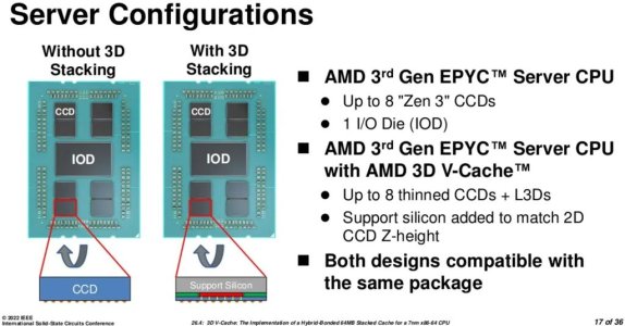

Looks like Cache below CCD is set in stone now, but will the Cache be on a big Die with lots of dead space or is it 3 dies underneath, one small with cache and 2 silicon pieces for structural support?
I was speculating about that. The structural support dies in previous gen V-Cache also offered better thermal connectivity, so it offered one advantage, at cost of more complex assembly.
A die underneath does not offer this advantage, […]
But it still could, with metal layers and thermal vias close to CCD hotspots, couldn't it?
StefanR5R
Dec 10, 2016
6,825
10,922
PS,
as a reminder, the current 3D V-cache™ implementation (Zen 3's, and certainly Zen 4's too) actually involves two kinds of structural silicon: The two little and thin pieces adjacent to the cache silicon, which are also pictured in the well known marketing material from AMD, and a large thick slab of structural silicon placed across all three thin pieces, which has never been shown in marketing slides but in an ISSCC 2022 presentation.
(source: https://www.ithome.com.tw/tech/151041 and other ISSCC 2022 reports)
