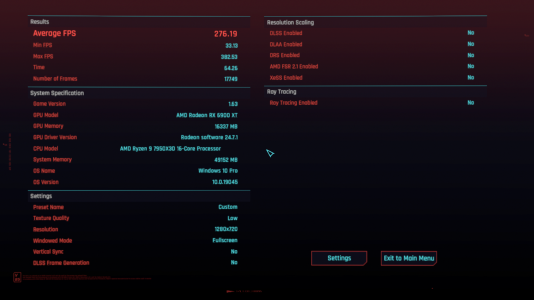

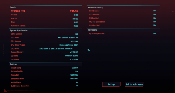

Hmm, initially i did not observe any difference between 'true' admin and normal admin in cp2077 integrated benchmark, but now there is some extra performance (although this time i've tested it with low settings instead of high settings, could be that the actual "game cpu"-limited part (which is where the fps is lowest, somewhere after the camera flies out of some alleyway into a plaza) doesn't really change with switching to admin account, but the part where fps depends on how fast the driver can process frames actually does, idk.
