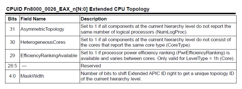

Here is your answer for hybrid:
If this is true, looks like it is launching on the mid-low end.
AMD managed to get the die size down to 137mm2. I am curious as to how they are doing this. Multi-die or mixing HP/HD libs on one die? Hopefully we get details soon.
Side Note: Would love to see them add (“small”) cores to the IO die for Zen 5. That would be one way to add cores without having to make multiple types of chiplets.
There are 6 Zen4 cores being shrinked to 4 Zen4C while use 4CUs GPU instead of 12CUs, only result in ~23% smaller die size??? If true what's the point of this design? I think even 6 OG Zen4 and 4CUs can do 137mm2. Something is not right.....(But this is Zen5 thread, so....)
All this doesnt make much sense on a cost perspective, if they do a 2 Zen 4 + 4 Zen 4c then they cant harvest efficently chips that have a non functional Zen 4 core and would be left with 4 Zen 4c cores, and if one Zen 4c is non functional that would get them a 2 + 2.
If that s 4 Zen 4 + 2 Zen 4c instead then a faulty Zen 4 core would lead to a 2 + 2, while a faulty Zen 4c would yield a 4 + 0.
Most logical would be to use 6 regular Zen 4 cores to get rid of those complicated and innefficient arrangements, the fact that the die is only 23% smaller despite a drastically cut down GPU and no AI is a hint that there s no c cores here.
