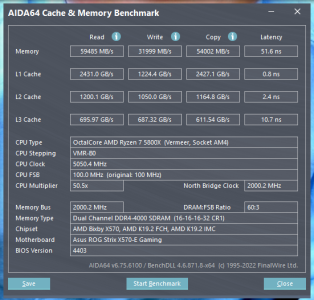

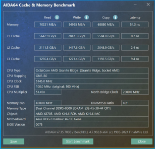

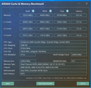

Lets now compare the bandwidth that's available for a single CCD
Single CCD Zen3: @ 2000mhz FCLK and 4000MT/s 1:1
Single CCD Zen5 @ 2200mhz FCLK + 6600MT/s 1:1
Single CCD Zen5 @ 2200mhz FCLK + 8000MT/s 2:1
Now tell me, do you still think its the memoryspeed itself that's the limiting factor here ?
Single CCD Zen3: @ 1900mhz FCLK and 3800MT/s supersuper tight memory timings (this is pretty BIS with unstable OC)
For memory to become bottleneck, you need to process data faster than that. Most multi threaded tasks work less than this rate. Maybe apps like 7zip decode, it maybe a bottleneck.

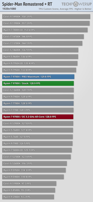

It really bothers me that the 9600x is almost 10fps faster than the 9700x in this bench by TPU. Even at different resolutions spiderman RT has an odd effect on the current Zen 5 CPUs. But also, for some reason this seems to be the only condition they tested that has this anomaly.
I think there is either a major bottleneck in the architecture somewhere or the firmware/bios/AGESA isn't working at 100%.
Could be issues with how L3 cache is getting sliced up with more L2 connected to it.
