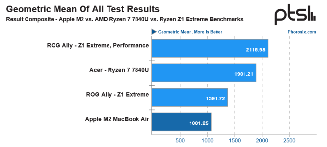

Apple can optimize their whole stack from the OS level down, including their browser. And for some benchmarks, they can optimize the entire benchmark too. There just won't be any other CPU that beat them at performance/watt simply due to this. Nobody really knows how much black magic optimization is happening for Apple devices running Apple silicon. Here is Apple silicon on Linux:
M2 gets absolutely trashed by Zen 4. M4 vs Strix would probably be similar. Of course optimizations in Linux for isn't perfect so there is gains to be had under Linux for Apple silicon but my point is the hardware isn't the whole thing. The Software matters, probably way more than people give it credit.
This is a dubious argument. SPEC cannot be made magically faster by a OS.
