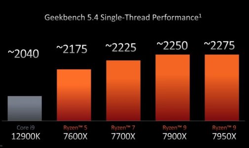

These results are consistent.
~520/GHz
At 5.8G it will go beyond 3K, which is pretty awesome, around 21%-24% improvement on Stepping 0, may gain a couple of percent with new steppings and microcode updates.
This is Zen4 official slide from 2022:
Despite GB5 utilize AVX512 that might push score a little bit higher(maybe ~3%), at 5.8GHZ score ~3000 which indicate 31% higher ST than Zen4, and this is just a Zen5 APU which has half L3 cache.
We don't know how well Zen 5 scales with frequency yet, but it won't scale linearly, just like Zen 3 and Zen 4 don't. It shouldn't be too far off, but it won't quite reach a linearly extrapolated score.

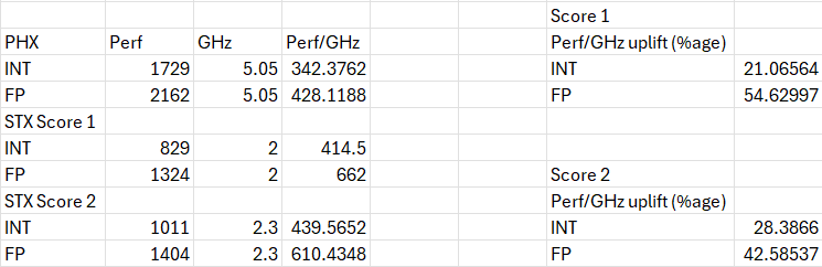

Integer scores are up but FP results seem to be down a bit.
The AES score is disastrous on both scores, it's dragging down the average significantly. Here's a breakdown with a PHX result that's actually quite similar to the one @Gideon posted earlier:
