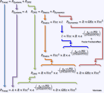

Power is function of Voltage squared. Which is also shown in the formulas.
I think, no one argues that. But besides @FlameTail getting even his simplified function terribly wrong there applies a certain additive offset and the curve might not be as steep in every interval. Much more so, when we talk about SoCs that have a looooot of uncore with a rather static consumption.
This is a measurement I already posted here several times in the past. It is from my own AMD 4700U Renoir. Look at the blue line, which is the duration of a CB23 run (secondary axis): Below 12w Package Power, the performance increase scales more than linear with power - the reason for a big part of this is the uncore consumption.
