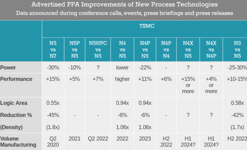

A14 = 11.8 billion xtors 88 mm2 die size = 134 MTr/mm2 (N5)
A13 = 8.5 billion xtors 99 mm^2 die size = 85.6 MTr/mm2 (N7P)1711690179477.png
Density increase = 1.57x
Which if my math is not wrong is lesser than 1.8x.
A13 = 8.5 billion xtors 99 mm^2 die size = 85.6 MTr/mm2 (N7P)View attachment 96050
You didn't read the table you posted. It says "logic area", while a real SoC includes transistors other than logic such as cache (leaving out the other categories that also aren't logic but maybe don't scale as poorly as cache)
We re talking of PPA, you are just changing the goal posts, as if density has something to do with PPA, it took you all this time to find such a poor straw.?..
A14 big core = 2.1 mm2
A13 big core = 2.61 mm2
Please tell me where the 1.8x logic density increase is in the actual chips?
Yes. A13 and A14 are almost the same architecture as far as the CPU is concerned. As demonstrated above, the logic density increase is nowhere near what TSMC advertises - because they typically have an old arm core as the reference.
And frequency/power claims are even more misleading. They typically refer to a simple ring oscillator, let alone a basic CPU.
How could one read accurately when he s so busy finding anything he can to convince himself that AMD wont achieve what he fear the most, that is, that Intel could be trounced for good.
That s no more a technicaly motivated debate but some kind of irrational discussion with one in need of some exorcism against his own fears.
Anyway yet another good laugh, at least that s some kind of entertaining.
It's not my problem if you are clueless, which isn't surprising.
