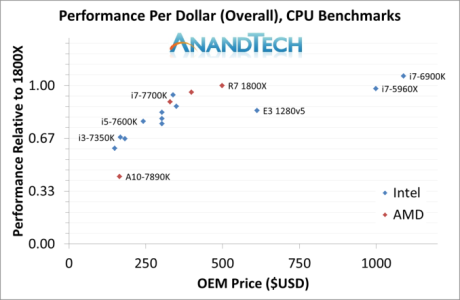

What are you talking about, it was above Broadwell, let alone Haswell, you should look at hold reviews rather than relying on random internet urban legends.
If you look at this overall performance comparison from the Anandtech review, the 1800X is ~3% faster overall than a 5960x and around 6% slower than a 6900K. (The gradients appear to represent 6.66%)
Getting detailed frequency info seems to be a challenge, but the 1800X spec is 3.6 base/4.0 boost while the 5960X spec is 3.0 base/3.5 boost.
Reactions: Tlh97 and dr1337
Abwx
Apr 2, 2011
12,034
4,996
5960X is quad channel, it help a lot in MT, that s not an apple to apple comparison.
Click on + 23 Eintrage and see where the 4770K is standing comparatively to the 2400G, that s a 4C/8T comparison :
