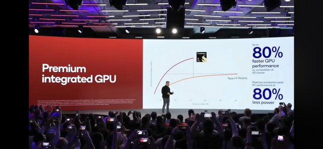

Well they better make substantial improvements, because this 780M curve looks ridiculous with how flat it is.
That was tested with a single-channel memory.
Single-channel G14 2023 SKU (that's like DDR5-5600).
16+0, the American one.
Funny bit of trivia!

branch_suggestion
Aug 4, 2023
905
1,967
Also, again, Adreno isn't a GPU, it can't run anything.
No drivers and very hacky h/w-side feature support in general.
Yep, vs dual-channel (quad but I digress) LPDDR5X-8533.
Considering RDNA3 clocks to the moon with enough power, that slide shows an obscene bandwidth bottleneck.
Bad Qualcomm, bad!
And they avoid benchmarking anything that isn't a glorified mobile benchmark, like video games.
FlameTail
Dec 15, 2021
4,384
2,762
Interesting. I didn't know this. Qualcomm is being sneaky!

adroc_thurston
Jul 2, 2023
8,635
11,346
Adreno is the child of your beloved AMD
Well it was, Qualcomm received full Xenos IP, DX10-compliant even (kinda) and made it a eunuch (they never used the ATi shader cores).
It's very good for phones but it's not a real desktop-class GPU IP.
It wasn't difficult times either, Ruiz saw no real future in merchant GPU IP licensing (and this was like the only time he was right, see the fate of Imagination).
