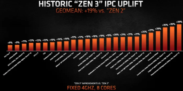

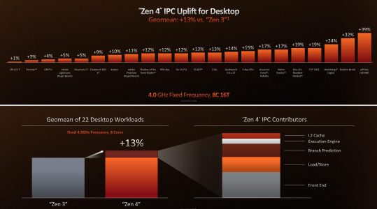

OK then, so its 30+ percent or 10+ percent? Cause, while not this SIR, but CB24, the rumored results pointed toward that lower number. Or could SIR bench results and CB scores be so vastly different?
CB results were always lower for Ryzen versus the real average IPC:
Zen 3 (avg IPC uplift ~19%; CB R20 1T IPC uplift 13%):
Zen 4 ( avg IPC uplift 13%; CB R23 1T uplift 9%):
For both Zen 3 and Zen 4 the ratio is roughly 0.68 between the two. If this continues to be the case, and if Zen 5 has ~30% avg IPC uplift (geomean, just like shown above), it is possible that CB 1T could be ~20% better vs Zen 4. Given how much bigger the core will be, and what was changed, getting 2x the IPC uplift of what Zen 4 got is not unreal at all.
PS The above Zen 5 numbers are pure speculation by me.
I feel like the pattern is much more complicated than just "AMD does worse on CB" and more to do with the specific arch implementation. Bcuz Zen 5 is such a large change, I have no reason to believe that pattern would hold.
