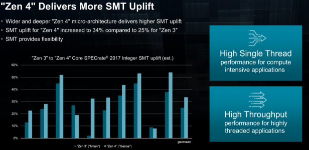

I was checking the Zen 4 presentation from HC and noticed this interesting slide that goes against what I posted before (SMT uplift possibly being smaller with a wider and deeper core):
What if Zen 5, being much wider and deeper than Zen 4, gets similarly greater SMT uplift to the tune of ~40%? If the core has an average ST IPC uplift of say ~28% and SMT uplift of ~40%, then it would be roughly 33% more performant in MT workloads / clock versus Zen 4 (what adroc claims):
1.28 x 1.4 / 1.34 = 1.33
Adroc claims Zen 5 SMT uplift is something like one third of Zen 4's.
Oh I must have missed that post, do you have a link to it? Interesting indeed. AMD's Zen 4 slides seems to suggest that the wider and deeper the core, it should get the bigger SMT uplift.
Edit:
I just did the napkin math and it doesn't really add up. To get 32% higher MT IPC in nT workloads, with ~11% SMT uplift (versus 34% for Zen 4), you would need some insane ST IPC for the Zen 5 core:
1.6 x 1.11 / 1.34 ~= 1.33
60% is never going to happen.

But that's not what he said , he said 32%1t not nt

IPC shouldn't decrease just by using multiple threads unless the cache or the rest of the memory system is creating a bottleneck.

@HurleyBird
Yeah but that is not an IPC claim, but throughput per socket claim (which means that clocks can be different once SMT is enabled). Plus, it's about Turin Dense, not vanilla Zen 5 version.
I think the other thing that can't be over looked is fabric bandwidth for dense , it's alot of very wide probably very aggressive prefetching cores for 1 ifop link. So fabric could be a limiting factor which then is addressed in zen6

@HurleyBird
Well this is SIR, about as SMT-friendly as it gets really.
Genoa SMT benefit is ~30%-ish there.
Anyway, I suppose it's possible Adroc only knows of Turin-D and there's some other bottleneck there that makes the SMT yield look bad, but if you look at the full context of the whole SMT discussion back then he's clearly claiming that the yield is way down (and Kepler makes similar claims).
