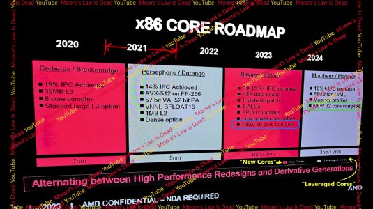

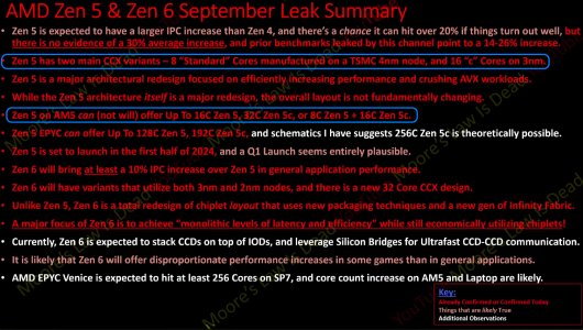

Well, it's looking more and more like I predicted, that Zen5 will be more like Zen3 (a big core redesign) and Zen6 like Zen2 (a big die/packaging redesign).
Well that AMD slide says 15+%. That is, 15% is a baseline.
Yep. The 'IPC 10-15%+' is look like the another 'ST 15%+' to me. Nobody knows where it will land at last.
Yeah given AMD's history, airing on a very conservative side in the runup (internal leaks or announcements) to a launch ("8%+" IPC for Zen4 actually being 13-14% on launch, "15+" ST perf actually being closer to 29%, the whole 40%->52% Bulldozer to Zen IPC ordeal etc), I wouldn't get too hung up what these slides claim. But I would say I certainly would be very pleasantly surprised if they surpass Zen3's 19% with Zen5.
Really interesting that AMD are hedging their bets on TSMC's next gen, again. I guess we'll get more hints on how realistic N2 Zen6 is when we get more details on what N3 Zen5 looks like (and when can we see it).

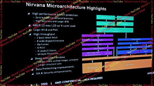

BTW can anyone explain what the Zen5 Zero bubble Conditional branches might mean? Or the "Memory Profiler" for Zen6?

CCD's don't need SoIC-X, something akin to Foveros is fine.
I think a bigger cost increment will be for 4 base dies, each one in 300-400 mm2 range than the cost of SoIC-X
Also, AMD will be using CCDs that will use SoIC-X for Mi400 or Mi500 to connect to the base die. Developing yet another interconnect technology would also have a cost well in excess of SoIC-X
4 tile is possible, but it has to be more cores than Turin, so you just inflate the size of each tile.
Maybe the server standard CCD moves to 16 cores with Zen6, but I really doubt it.
Dense CCD 16 cores for sure, the 32 core thing I'll defer to the likes of Spec.
Also the dense part probably has some structural changes outside of the CCD's, the target market and all.
Well, the slide says 32 core CCD for Zen 6 which kind of implies it is for Dense and Standard then would most likely be 16 core.
There was a video by Jim from AdoreTV about some sort of Elevator ring / bridge, which could make moving to 16 and 32 core dies possible with lower penalty.
The fanout introduced with RDNA3 is nice and cheap, and works well for this purpose. Si bridge would be overkill.
I don't know how the machines for SoIC Hybrid bond work, but it is quite possible that the equipment doing it will place all 2nd floor on top of 1st floor dies all at once.
So it it is going to be placing 16 to 24 CCDs, plus 4+ bridges, adding another 4 bridges will be a minimal cost increment (if there were separate IO dies).
It seems to me that stacking the dies one by one if there are going to be so many is unlikely.
Another thing, AMD was already planning on placing 9 Shader dies + 3 bridges for Navi 4c in 2024. It seems quite likely that this assembly is likely stacking them one by one.

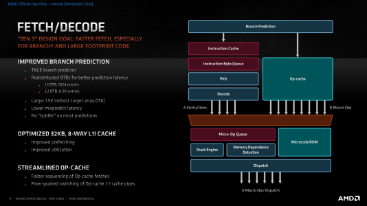

Edit: Formatting
I assume zero bubble conditional branches means they've found a way to make the penalty of a branch misprediction zero. Normally, a branch misprediction stalls the core because the core is flushed and the execution units have no work to do until the instructions from the correct branch make it through the pipeline. Imagine the core is a pipe that flows water, and it is your goal as a CPU architect for water to flow as fast as possible through the pipe. The gap between the flush and when the execution units have work to do is the "bubble", essentially an air pocket that halts your water flow.
Zen 3 had a heavily improved branch predictor with zero bubble on MOST branches, but not all. Seems like Zen 5 addresses the remaining corner cases? If it's true capable of zero misprediction penalties across the board, that is HUGE.
From AT's Zen 3 article:
AMD claims no bubbles on most predictions due to the increased branch predictor bandwidth, here I can see parallels to what Arm had introduced with the Cortex-A77, where a similar doubled-up branch predictor bandwidth would be able to run ahead of subsequent pipelines stages and thus fill bubble gaps ahead of them hitting the execution stages and potentially stalling the core.

Also, we don't know (yet) the size of the very important uOP cache, which was big update for both Zen 3 and Zen 4. I expect this structure to get a big size increase in Zen 5.
Saylick
Sep 10, 2012
4,124
9,642
Same. Likely holds more uops and larger dispatch. Zen 4's uop$ already had 9 ops/cycle and the core is fed from the uop cache most of the time, so it's only fair that a wider core requires more throughput from the uop cache as well. Hopefully, it's something like 12 ops/cycle or more to compliment the zero bubble misprediction on conditional branches.
For FWIW, AT's Zen 4 article:
Meanwhile the branch predictor’s op cache has been more significantly improved. The op cache is not only 68% larger than before (now storing 6.75k ops), but it can now spit out up to 9 macro-ops per cycle, up from 6 on Zen 3. So in scenarios where the branch predictor is doing especially well at its job and the micro-op queue can consume additional instructions, it’s possible to get up to 50% more ops out of the op cache. Besides the performance improvement, this has a positive benefit to power efficiency since tapping cached ops requires a lot less power than decoding new ones.

Decode width is unknown too. Odd it is not mentioned in the highlights. Would be a bit weird if it remained at 4.
I think that it's very obvious AMD wanted to leave some very important stuff out as that presentation was bound to get leaked quickly after they shared it. If we got it now, competition got it much earlier. I don't think that anyone from intel was taking the 10-15%+ IPC "projection" seriously
That is frankly nonsense without having access to time machine inside a core ( or having "pipeline" of 1 unit ). Nice explanation tho.
Zen 3’s L1 BTB could track 1024 branch targets and handle them with 1 cycle latency, meaning that the frontend won’t need to stall after a taken branch if the target comes from the L1 BTB. Zen 4’s L1 BTB keeps the same 1 cycle latency, but improves capacity.
So they just have 0 latency "bubble" meaning that frontend does not stall after taken branch.
The other clue is 2 basic unit fetch, just like Atom core with 3+3 decode in prev gen, they can fetch from conditional branch target -> there is probably a lot of flexibility uCode vs L1I, maybe some other smarts?
I think this all pretty much means they have beefed up raw decode as well. 6 wide would make sense?

From what I see the newly leaked slides show reasonable evolution.
8 dispatches sounds reasonable to accommodate the 5-wide decode compared to 4-wide.
Nothing really surprising seeing how I've predicted as much back in April for example about the number of ALUs: https://forums.anandtech.com/thread...ranite-ridge-ryzen-8000.2607350/post-40983226
Memory profiler sounds like usage analysis to help optimize allocation between the cache levels.

These leaks about layout and number of ALUs and all are nice but we will not know almost until launch what are those resources capable of.Like instruction exec latency. Zen 2 to Zen 4 have not seen ALU count change but they got vastly improved.
We know for instance that L1 changed from this slides, what about L2 and L3?
I am reaaaly looking forward to read arch deep dive. :)
