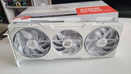

Ordered my ram. https://www.newegg.com/g-skill-32gb-ddr5-6000/p/N82E16820374614?Item=N82E16820374614
I checked and it's supported by all the boards I'm still considering.
Right now it's between the Asus Rog Stix and Gigabyte pro ice. Which I know are overpriced for a 9800+3D gaming build, but god dangit, I'm a slave to wanting that white rgb crack... I did consider the older gigabyte 650 board for $200 instead but the sickly off color eggshell white turned me off from it. I don't mind the price too much because if my current board is any indication, I could have this thing for 6 years before starting from scratch. In any case, I'm in the home stretch.

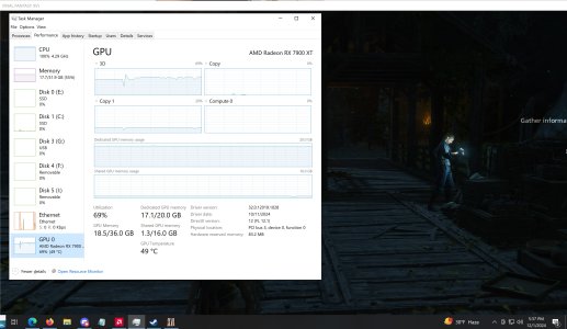

My 7900XT arrived. Even in my old system it made FF16 go from unplayable to very playable instantly. My 8gb 3070 choked on this game as apparently it gobbled up over 17gb of vram now that it has 20gb to pull from. On the other hand, my FF14 fps remained completely identical to my 3070 despite still only hovering around the 40-45fps average with lots microdips stuttering inbetween. I tried raising graphic settings and fps stayed the same... CPU bottleneck. I never bothered overclocking my intel 9600k all these years because I was scared of overclocking and figured it wouldn't make a big difference at 4k resolution. But boy was I wrong. I spent a couple hours learning about overclocking and pushed my 9600k to 5ghz and suddenly that was the thing that improved my FF14 performance to 56fps average. FML. I think the CPU is holding back FF16 too because it's only utilizing 70 ish percent of the 7900XT despite not even a 4090 being enough to run this game at 4k 60fps ultra without dlss. Hurry up, Amazon. I really don't want to wait until Dec 20th to get my 9800X3D. It's long overdue!

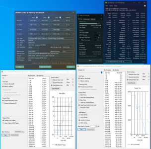

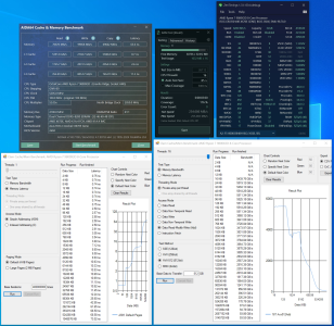

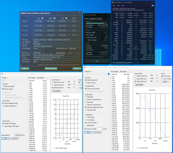

So i'm back from work and have had some time to test ASUS's new "Core Tunings Config for Gaming" feature
Results are a little of a mixed bag
I flashed from bios 2505 @ agesa 1.2.02A to bios 2604 @ agesa 1.2.02B and configured my known to be fully stable 8200/2233 memory-profile
Some general observations:
  • "Core Tunings Config for Gaming" AUTO = legacy mode *edit* Getting different feedback from ppl reporting auto = level 1/2 for them, dont know why its different
  • Aida is getting less read and higher copy, while write stays the same, compared to agesa 1.2.02A
AIDA64 latency results:
  • AUTO (legacy) = getting the best latency in aida as expected
  • Level 1 = same aida latency as 1.2.02A
  • Level 2 = same aida latency as "level 1"
Clams cache/memory benchnark:
  • AUTO (legacy) = scoring the same as older agesa 1.2.0.0
  • Level 1 = scoring the same as older agesa 1.2.0.0
  • Level 2 = = scoring the same as agesa 1.2.0.0A (highest numbers)
Karhu mb/s:
  • AUTO (legacy) = getting the least mb/s
  • Level 1 = setting a new high, have never seen upwards 256mb/s max numbers in only 3 min runtime
  • Level 2 = the same as agesa 1.2.0.0A
So each of these different settings have their own strong suit.. And we are back to ppl have to test their specific game/benchmark to decide whats best for them in their application -> there are no universal answer for "best settings"
Core Tunings Config for Gaming = AUTO (legacy)
Core Tunings Config for Gaming = Level 1
Core Tunings Config for Gaming = Level2
