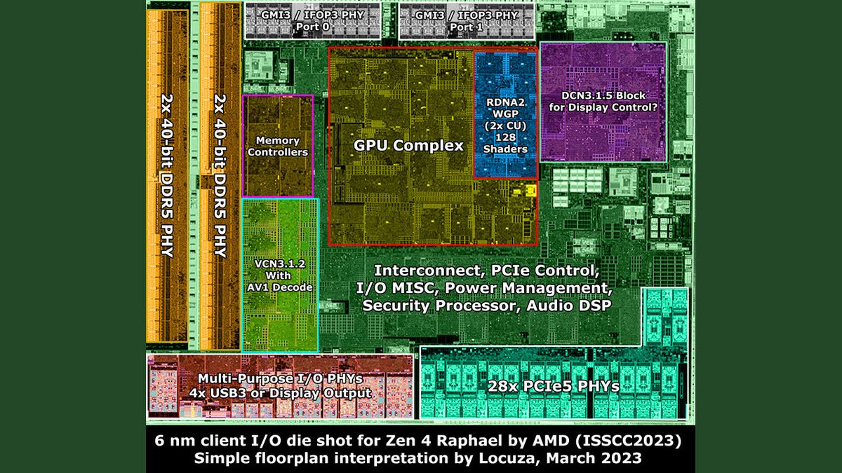

Most of it is known, but nice to have some official slides
Here is the answer to the significant frequency gains achieved, they are using HPC HD cells (2x2, 6T) with eLVT. Also the reason for the significant loss of density. Good news if they will be a bit more conservative with clocks targets on Zen 5, they can really claw back so much density.
GMI3 IFOP data with lane count and official logic area without the scribe lines and filler.
Pretty much confirms what was known before, that the CCM has 2x GMI lanes.
Not much other stuffs that is not known already.
Such a breath of fresh air not having to digest "leaked information" for once.
moinmoin
Jun 1, 2017
5,248
8,463
Here is the answer to the significant frequency gains achieved, they are using HPC cells with eLVT. Also the reason for the significant loss of density.
This likely will be also a big part of the density gained in the Zen 4c cores. Going by these graphs those cloud cores may still be capable of frequencies 3% above Zen 3, but ~11% below the high frequency optimized Zen 4 cores.
Which furthermore adds the advantage of more redundancy for better yield.

Zen 4 using HD rather than HP cells mostly was quite a surprise for me tbh.
How much density does eLVT cost? Couldn't find a figure. Besides, doesn't the graph say the 70% of the core is still the standard 5nm HD cells, with the specialized cells prob just being along the critical paths?
So I don't know if this means Zen 5 could claw back much density. Even if they go for no frequency gains or even a slight frequency drop, aren't wider architectures, which zen 5 will be, harder to clock higher as well?
