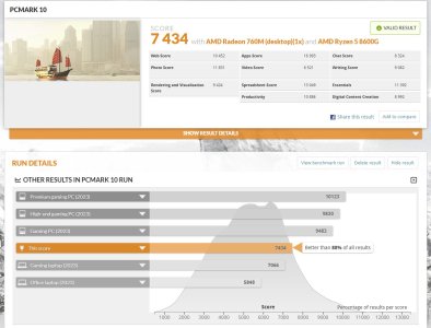

Ok, got this problem figured with the Ryzen 5 8600G system in my signature & the Corsair Vengeance RGB 5600MT/S kit. Seems the board was undervolting the XMP profile VDD & VDDQ voltage lines. Vdroop is probably the more appropriate term here. But anyway its sorted now.
Ran PCMark10 default run with cpu on defaults & XMP profile loaded with correction to the RAM voltage lines. 1.26v for VDD & VDDQ seems to fix it instead of 1.25v default for both. This was the only way to get the system to reboot successfully with this RAM kit @ XMP profile timings.
Some perspective on the results in comparison with the rest of the scoreboard;
What's fascinating about this chip is the way the FCLK & UCLK speeds fluctuate depending on system usage at the time. Didn't see that in the 7000 or 9000 series chips I have.
Considering the system is more productivity focused, I'm pleased with this so far, but the tweaker in me can't help himself so more OC results will be incoming soon... :)

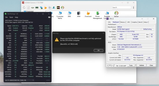

Side note; Aida64 v7.35.7000 benchmark report shows the IMC running in quad channel unlike a 7950X listed with dual channel! Not sure if this is a bug in Aida64 or not.
Maybe that's required to get more performance out of the iGPU? What do the bandwidth figures look like for your three CPUs?
Can do that, but will have to be at 5200MT/S CL40 for all systems as the Adata B die kit in the 7600X rig is not a good over clocker ( new kit coming next week) to be stable pass that speed & timings without too much VDD. Just need a bit of time to get all 3 results.
Edit: not going to happen atm.
