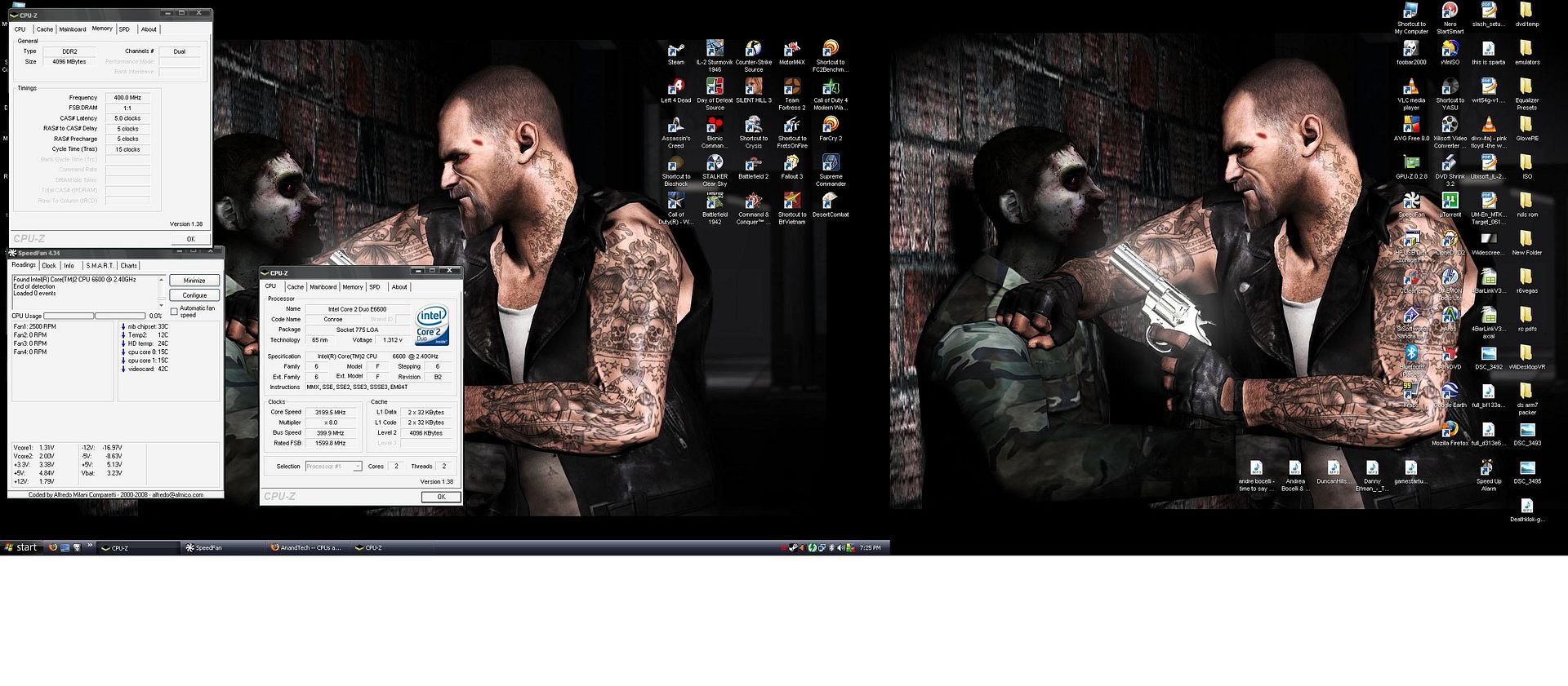

http://i148.photobucket.com/al.../yodapwnedjoo/dest.jpg
check that your PCI-E width is still x16 after overclocking. Sometimes, it will reduce to x1, and that will cripple your framerates.
Incidentally, I highly doubt your cores are idling at 15C unless you keep your room unusually cold. That's below standard room temperature.
lol didnt notice that cpu z says its on 1 x . imma look for the setting in bios but i dont remember seeing it?
ok so there wasnt any settings to change the pci-e speed, some quick google action turned out that if i had my pci speed set at 105 mhz it would fix it.
it worked .
does anyone know why it would fail to run at 16x at 100mhz pci speed?
