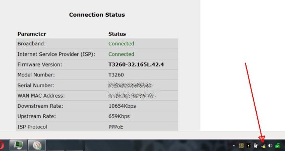

When the yellow triangle appears over the network taskbar Icon, what isn't connected? What triggers that triangle?
Modem shows connected. Upstream and downstream rates are degraded in this screenshot, normally they're 30/1.8 or so, but all modem light are green and status shows as connected. But regardless of modem status or rates, if that yellow triangle is showing, I can't browse or even ping anything.

Nothing like any of that. It might only be a few seconds, or it could be several minutes, but it clears by itself and I can browse again. Windows has to be pinging something somewhere that tells it yes or no. Something in NetSvcs maybe. Whatever it is has to be beyond the ISP network nodes that tell my modem it's connected.
Current DNS numbers are 8.8.8.8 and 9.9.9.9, but that doesn't matter either as it still happens when I change them.

No. That's all the same stuff. Tells you all sorts of things to try, but it's usually back before I could even get halfway through that. And it doesn't even begin to say WHY or what triggers it. Windows has to be pinging something somewhere to know when to display it.
I can see trying those things if you're having network issues on one machine while others work. When this happens EVERY machine, wired or not is disconnected from the web.
It's downstream somewhere, but no one seems to know how Windows knows it can't browse.
