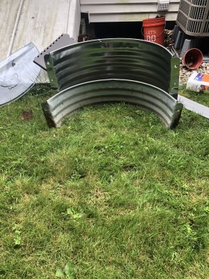

No drain found. Old well barely made it to the bottom of the window and that was nearly level with the ground. I got an upgrade, this one is a bit too tall I’ll just leave it 5” above ground level that way I can add soil to hopefully help the run off
