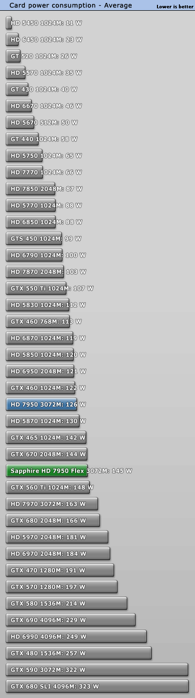

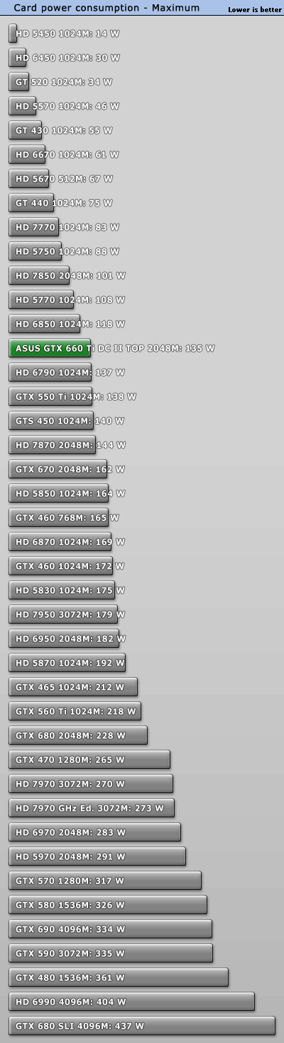

Yes, but AT don't actually measure what the actual card consumes:
So that is 660TI at 145W vs 7950 at 144W (effectively a tie) using "Crysis 2 at 1920x1200, Extreme profile, representing a typical gaming power draw."
But running Furmark, they get 660TI at 135W vs 7950 at 179W. That's 44W so it seems Nvidia are throttling whereas AMD are not.

200W for the 7950, 225W for the 7950B, how did you even calculate that? That's 100% wrong. The Metro 2033 Load numbers are for the entire system, that means it includes added power consumption from CPU workload too. I also bet you they are at the wall as well. You simply took their load and idle numbers and subtracted them. So you made 2 mistakes:
1) Included loaded CPU power consumption and the power consuming X79 chipset power consumption, along with the 7950 GPU; the CPU they are using is a Intel Core i7-3960X @ 4.3GHz. That CPU alone draws a ridiculous amount of power.
and then X79 chipset motherboard draws more than LGA1155 motherboards:
You didn't account for any of that, and when you add it up an i7-3930K OCed system draws an insane amount vs. a 2600k:
So instead what you just did is added all of those X79/3930K power hog properties to the 7950.......
2) Didn't account for the power supply inefficiency. They are using an Antec 1200 Quadro Silver rated = 85%. So you'd need to multiply all of that by 85% to begin with.
Just think for a second what you are even saying. A stock HD7970 draws less than 200W. So how can a stock HD7950 draw 200-225W. It's obvious the way you used those numbers is wrong. My HD7970 draws around 215-220W at 1150mhz! I used a P3 Kill-a-Watt to measure it. How can a stock HD7950 draw 200W? 🙄
MSI TF3 7950 = 142W

Plus, HD7950 B's reference card power consumption is pretty much irrelevant since that's not what the consumer will be buying. All 7950 after-market cards use much lower voltages and draw less power. There is only 1 HD7950 GPU Boost reference card on all of Newegg vs. 18 other7950 cards. See Tom's chart above and you can see after-market 7950s even with 880-900mhz still draw less than 160W.
