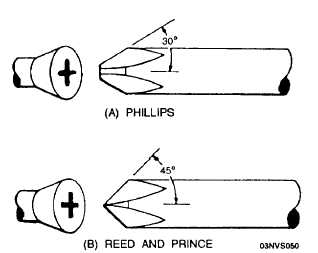

People also screw up Phillips screws by using a Reed and Prince screwdriver. A proper phillips screw and driver are hard to strip out by hand or a driver.
People grab a reed and prince screwdriver and ruin phillips head screws and blame it on the phillips head.
I think its getting harder and harder to get 'proper' phillips screws. Instead you get ones that start deforming at the slightest resistance - even when they were packaged with the very item they were supposed to screw into
