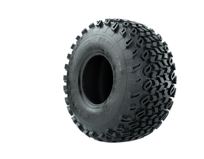

I put some ATV tires on my larger cub cadet and it was fantastic compared to the turf treads. looks like less selection in your size. Here is an option. bar lugs are also good but could tear up the grass a bit if they are spaced too far apart. check ebay, its where I have gotten odd sizes of tires in the past.
if you have the clearance a 20-10-8 should work I think, and there seem to be a few more choices in that size.

I'm thinking the 20 x 9.5s would work. I see pairs of these for $130 or so shipped
I have chains on my 20 x 8s and there is still enough clearance, so I can't see 9.5s being wider than the 8s with chains.

i had chains as well, and never used them after i got a tread like this. i was able to use my plow to spread gravel on my driveway with these. my CC was an 1995 model of their large "garden tractor" weighing around 900 lbs.
