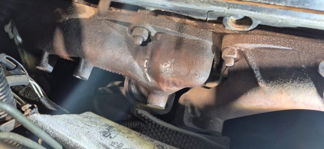

I hope it will hold, never tried brazing before.

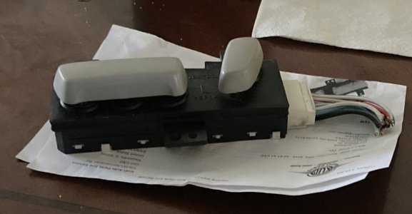

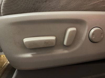

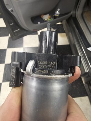

Our 14 year old Sienna loser cruiser power drivers seat wouldn’t go fwd or aft. Wife is way short and of course it failed as far back as it travels when she exits.
Using a trim removal tool we pulled the switch covers off to access the front switch. No broken wires, so we sprayed the shit out of it with contact cleaner and put it back together. It worked! For three days…
I bought a guaranteed serviceable switch off the Bay. It worked for a week. 😡
We just yanked the motor. This better fix it!!!
I’ll update this when the part comes in.
Silly me thinking something would arrive by USPS relatively soon during the Christmas holiday shipping frenzy! Shitlol
A guaranteed serviceable motor finally arrived. Installed & ops checked good. MEL’d driver’s seat manual pillow installation before operation cleared. Sienna loser cruiser returned to service.

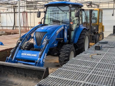

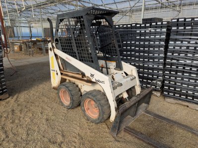

I started doing annual maintenance on the equipment yesterday. Just the usual stuff like oil, air, and fuel filters plus greasing all the pivot points and checking hydraulic oil levels. It's only four pieces of equipment but it is time consuming and usually takes me a couple of days. The Bobcat 440 skid steer and the New Holland Boomer 41 are the easiest so I pumped them out first. The Yale forklift is the worst because of the weight and I don't have a pit so getting under it is no fun.
My supplies cart is fully loaded.
Pic of the tractor and forklift.
My baby skid steer. Ain't it the cutest little thing you ever seen? lol
Dude...you have a bucket on that NH tractor...easy to dig a quick pit.
I wish I could but it's not an option. The little 41 hp diesel just isn't powerful enough to break through the frozen ground and by the time it warms up enough to do it I will be to busy with other things. I might do it later this spring though like at the end of May when I'm not as busy. Thanks for the suggestion.

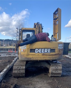

The excavator pooped out on the job due to plugged fuel filter(s). I tried a drain and rinse to get it going, but failed to get a good prime. I ran for a pair of new filters and 10 gallons of fuel to assist with priming. New filters and I had to go to the engine driven pump and run that manual plunger to get everything primed.
Body surfing the counterweight to get to that one.

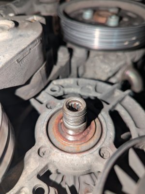

More mechanical issues. On the way home, the TDI Beetle tossed the serpentine belt.
I got home OK thanks to the mechanical engine that uses no electricity, just really hard steering.
The sprag clutch in the alternator probably failed and took the pulley off. I have a pulley and tool on order now.
The alternator and shaft are fine.
