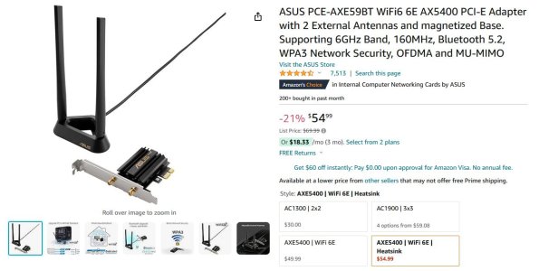

That's weird, I thought the link went directly to this Asus one above. Anyway, this is the one I'm looking at. The antennae does have a cord to place it wherever would be optimal
The one Ajay linked does have that as well, only significant difference I saw with his was that it's 2400Mbps vs 5400 with the Asus above. It is a decent amount cheaper though, and decent reviews on that one as well

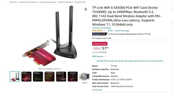

Thank you for that information. Looking at that, it looks like I'd get the same speeds with this one, but for cheaper, right?

It's all marketing of the same M2 which is Intel and the AXxxxx speed in the name is just combining the different radios.
$20 - M2 card AX210
Get a backplate w/ antenna holes / antennas / pigtails or buy the kit.
There's no need for the PCB / heat sink as they don't get hot.
If you have a 12th gen Intel CPU or newer you can grab the AX411 or skip the BS and just get the BE200 for $20 and be WIFI 7 equipped for when you upgrade your router / AP.
$20 - M2 card AX210
