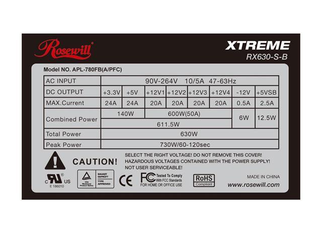

The Rosewill's 3.3V and 5V shared a single rail all the way out to distribution endpoints. This made it even more prone to cross regulation failure. Very common to older designs and low end PSUs.
http://c1.neweggimages.com/New...mage/17-182-149-17.jpg
The Istar's 3.3V and 5V share a single rail but both 3.3V and 5V used independent secondary. which allowed for greater output current and the 3.3V didn't have to withstand as much blocking voltage as the Rosewill's 3.3V was forced to.
