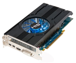

You can also look into the HIS IceQ Turbo 7950 if you have 3 slots of space in your case.
