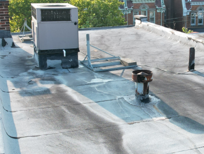

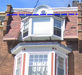

this is my house from 1900 in Philly. the dotted blue line is the 3rd floor ceiling. see that circular hole at the front? when i am in this front room, i dont see this hole anywhere. so im 90% sure i have an attic.
also, on the roof, i have this central air for cooling. no idea if it can also do heating. for now, we heat with the radiators.
there is this spinning thing as seen on the right side. i am guessing it is for cooling the attic when wind blows by?

Oh wow a flat roof for a house. That's not too common. That whole setup looks more like what is typical of a commercial building, even got a packaged HVAC unit going on. But yes there may still be a small attic in there, that circle is a vent. Going to guess you got metal trusses in there like you see in the ceiling of places like Walmart and they just made it into an attic, almost wondering if this is a converted commercial building. Blown insulation could be tricky to do in this case as there probably is not a lot of room to work with.

There's no opening in any closet?
none. i will cut a hole in one of the 3 closets to verify what's beyond the ceiling. will use an endoscope through a half inch hole first. then cut a bigger hole once im confident there is more space to work with....
i would say 90% flat. there is sloping for all the rain to run to the back and into the downspout. this is actually very typical for Philly row houses. or at least all the houses i ever bought (3)
