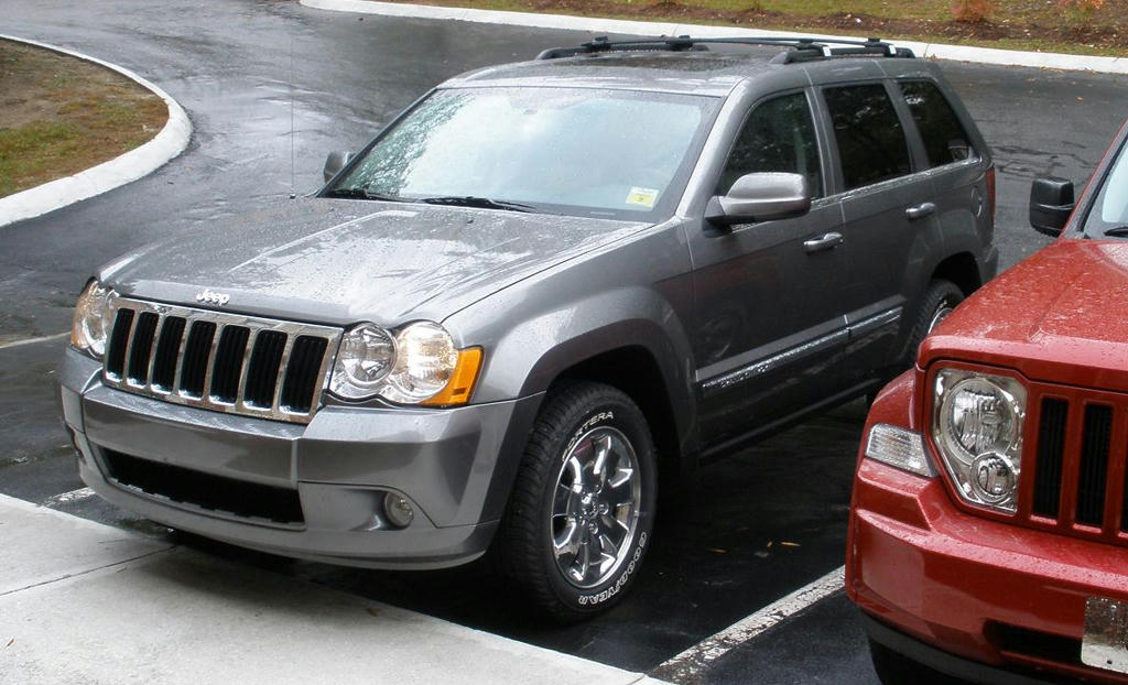

Originally posted by: LTC8K6
http://www.mediafire.com/imgbn...ca4280100eb6e5d16g.jpg
The 18" wheels just looked a lot better on my Jeep to me.
Yes, but with 18 inch rims a jeep still has a good amount of tire side wall height left. I think the OP is refering to the very low profile tires.
I've seen way too many people ding a rim on a pot hole with the low profile tires to ever think they are practical. Besides that I think they are pretty ugly anyways.
Partially. Low profile tires have their place but they wear out so quickly and put more stress on the wheel, yes. I wouldn't want them unless I was absolutely confident in the durability of my wheels and prepared to replace them every 10-15k miles. On a 14" wheel, low profile tires might not cost so darn much to replace (though they are not so common, I would imagine). On 18" wheels, tires get expensive.
There's a guy who lives nearby that has a VW (I think it's a GTI) with huge rims and little rubber band tires. I often wonder how he manages to avoid ruining his wheels on the roads around here, but somehow, he does it. Someone took out one of his side-view mirrors though (passenger side; he hasn't repaired it after being damaged for several months).
