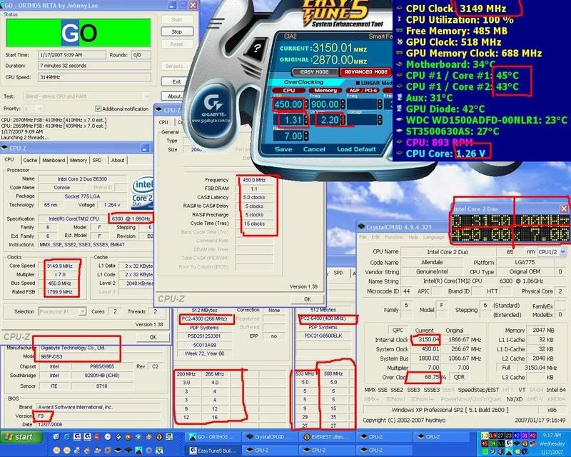

I have 2x512MB Patriot DDR2 1066 PC2 8500 , and 2x512MB Patriot DDR2 667 PC2 5300.
CPU-Z shows that my DDR2 1066 is actually a DDR2 800, and the DDR2 667 is actually DDR2 533.
They are sold as DDR2 1006 and DDR2 667 since they are hand-picked and binned at higher speed.
I have all four of them running on my DS3, and test them at 450FSB.
That means the DDR2 1066 is running under spec , but the DDR2 667 is running at DDR2 900.
SCREENIE of DDR2 1066 AND DDR2 667 RUNNING TOGETHER AT 450FSB, DDR2 900
I don't have issue running 4 sticks, but then, they totalled 2 Gigs, not 4 gigs.
