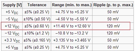

Tolerance table.

That would be 12.5% out of spec which is above the atx standard of 5%.

ATX standard says 5%. Adding other facts say why a measured tolerance is different. Better answers provides unadulterated data - the numbers - so that others who know more about this stuff can post informed conclusions. An accurate answer immediately and without any more RMAs.
