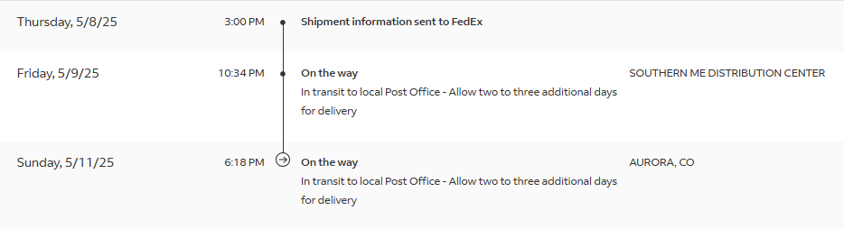

I have a fedex package coming that has had no scans since 5/11 in Colorado. Should have been in California by now. :(
