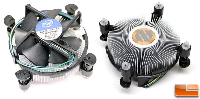

Stock cooling should be fine for 4.5 Ghz provided you got a good enough sample and your case has good airflow. (My own 3258 has been stability tested at 4.6 Ghz with the stock cooler in an open air environment)

P.S. Intel provides a cooler rated at 95 watts with the Pentium 3258:
http://www.legitreviews.com/intel-pentium-g3258-processor-review-quest-5ghz_145874
(Pentium G3258 cooler)
