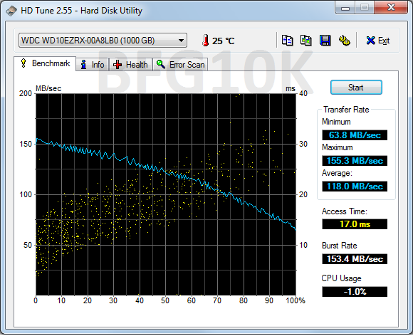

I have the newest 1TB/platter Green and Blue drives. Here are the HD Tune scores (Green 1st, Blue 2nd):

Thanks for posting those graphs BFG10K.
I was just wondering is Greens were better for storage purpose only.
Great informative post btw.
