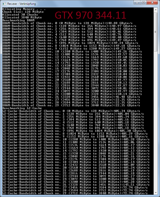

Can somebody with a GTX970 use the first Maxwell driver 344.11 and test it again?
In the overclock.net forum is a guy who posted a picture with the driver and he has no problem...
He has the problem. Look at his results again. Both VRAM and L2 bandwidths are getting hit for at least 512MByte of chunks.

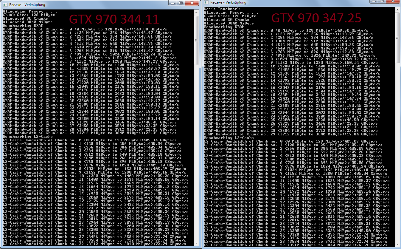

This is interesting. Now Chunk 25 is running in full speed. Best GTX 970 result so far. I'm going to install 347.25 now and will do a re-test with this driver.

344.11 is indeed faster in Chunker 25. Tested while iGPU is in use.
